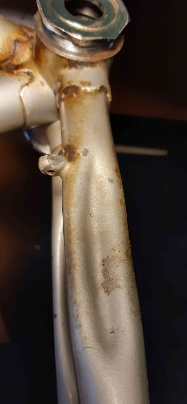

I am by no means a Peugeot specialist, and you may well be right, but those Prugnat 62bis', the semi-wrapover seat stay style, and that fork crown (Ekla H?) are not details I recall having seen on Peugeots. Have you any pictures?

I looked up Prugnat 62bis and Ekla H and these are an exact match for my frame and fork.

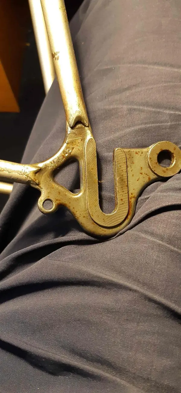

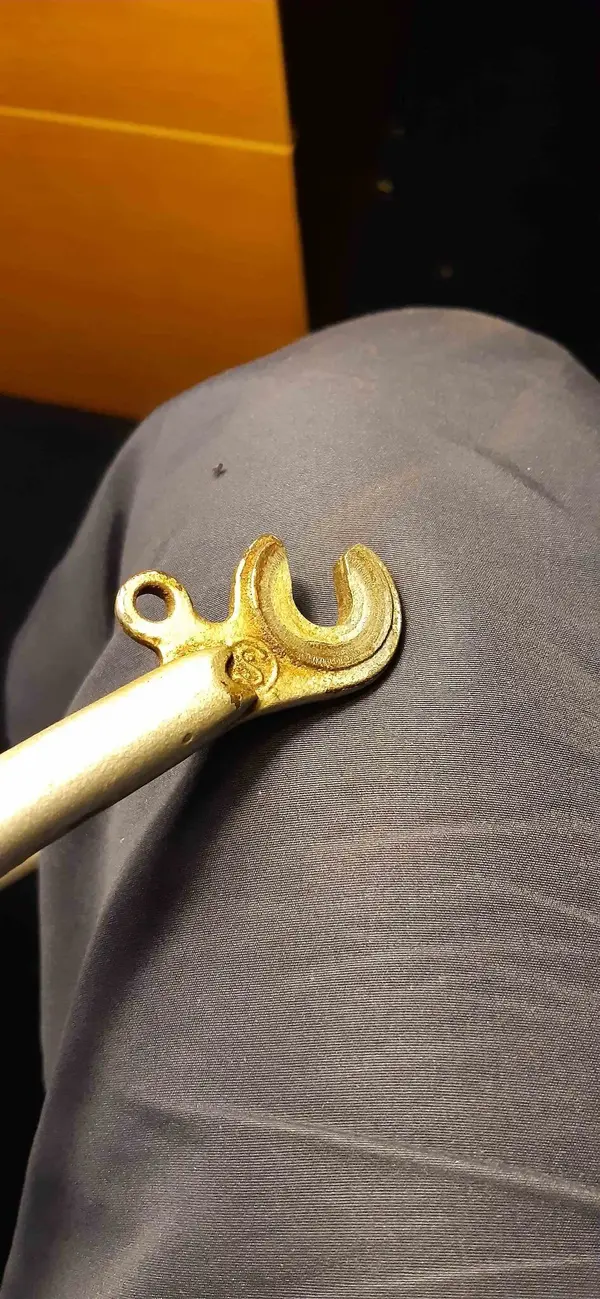

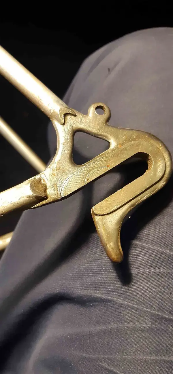

BTW, could you perhaps post pictures of the dropouts and fork ends? They might help with the identification. TIA.
Thanks again!
I thought I saw fishmouths in one of the earlier pics. Crudely made, although that doesn't seem to say much in France about the quality of the bike. It does imply a factory build, rather than artisanal.
The dropouts are Simplex pattern Ref. 1752 & 1753. Made until 1973, AFIK.

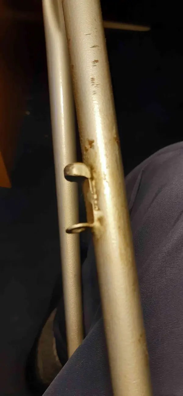

Another thing I noticed is that the RD cable stop on the chainstay is located further forward than usual.
