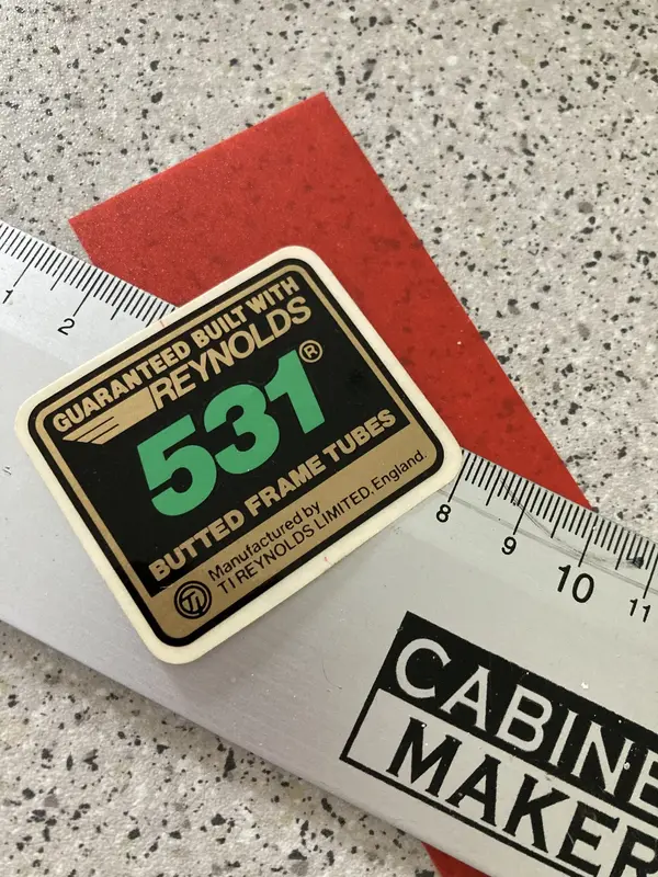

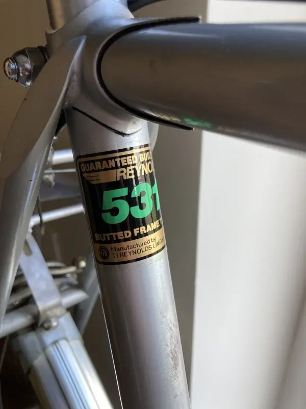

Waiting for a few bits to arrive but have reinstated the missing 531 tube sticker in the mean time. The bike is an 81 which I believe was a cut over year in the Reynolds decal designs. Decided on this one which is NOS from 82

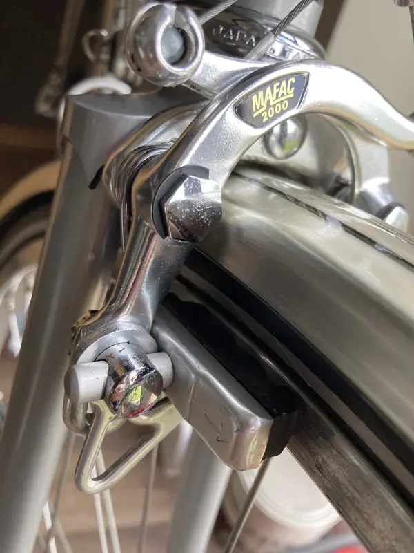

The Mafac 2000 brakes came up very nicely too

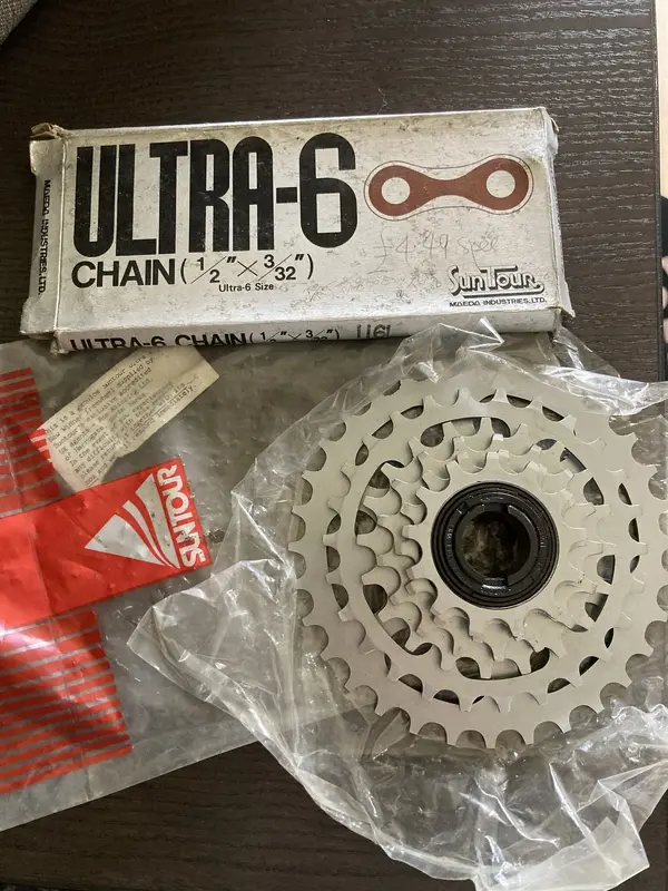

Just reading up on the Suntour Ultra 6 freewheel..6 cogs in the space of 5 with narrow chain. The bike currently has a five speed set up but I have a nos ultra 6 chain so may look out for the correct freewheel…only found silly US prices on eBay so far. Supposed to have a 13-32 spread which is bigger than all my MTBs !

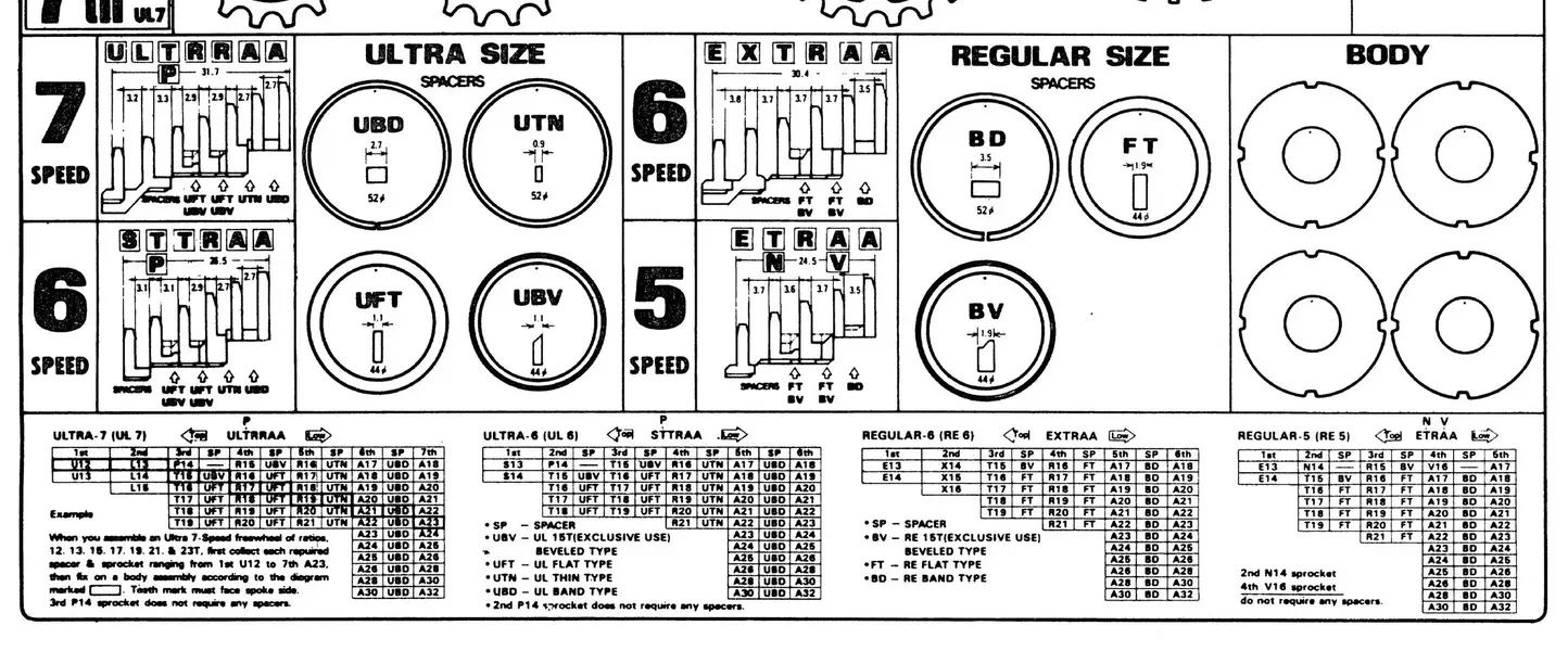

The New Winner is easy to set up - you just need the right spacers and cogs - and you need to assemble them the right way round (otherwise it shifts badly).
This is a bit cryptic but shows which cogs/spacers are needed

Thanks..I had started to look at that as one possible way of getting a freewheel with the ratios I wanted. Looks like 6 and 7 speed ultra is interchangeable too which helps

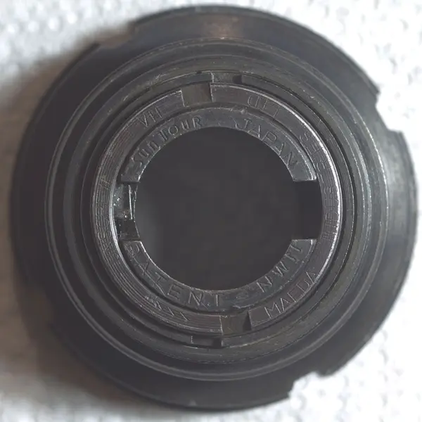

If you're talking New Winner it's one body for 5 / 6 / ultra 6 / ultra 7.
But some of the cogs are different - generaly the smallest 1 or 2.
But Ultra 6 and Ultra 7 have the same spacers.
If you look closely it's all explained on the bottom row of that chart.
Also note "teeth mark must face spoke side" - the A (biggest) cogs usually are stamped "A32" or similar.
The side with that mark faces the spokes, if you fit it the other way round it will work but it shifts badly.
All New Winner bodies have "Patent NWN" stamped on them.

Ok, so it’s taken a while but managed to track down a NOS Suntour Ultra-6 freewheel ..thanks to the kind folk who hoard stuff on here 😁. Will get that installed and then some cables on for the weekend.

Don't wear it out, you probably won't find another one!
