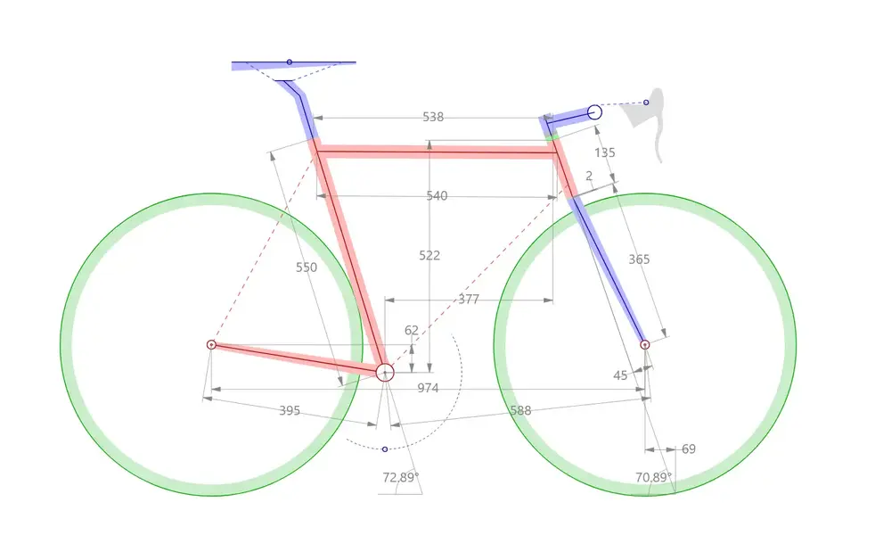

That looks like some interesting geometry. 55st-53tt??? Looks like criterium geo if so. I'd guess very late 80's to very early 90's. Id lean more towards the 90's because of the vertical dropout's. SLX (did you feel for the ridges in the seat tube and down tube?) was introduced around 1987 and wasn't really a thing by 1992 being replaced by Aluminum or oversized steel.

I think that geometry must have some mistakes in it.... Maybe seat and top tube the wrong way around. It would look weird with a longer seat than top tube, even in the pictures right?

Ok, it has arrived, and the geometry is as stated (see pic below). It's is an English threaded BB.
It's got the helical ridges (super butting) at the bottom of the seat and down tube, so pretty sure it's SLX.
26.8 Seat post diameter.
Helical ridges and 26.8 seat tube diameter??? That should be 27.2 diameter seat tubing if it's SLX. They never made SLX with anything other than 27.2 ST dia. And while rare to have a seat tube brazed upsidedown. A Columbus SL/SP ST brazed upsidedown gives you a 26.8 ST. Which does happen every so often. That would be impossible with SLX. The ridges would be at the top and make it unusable.
