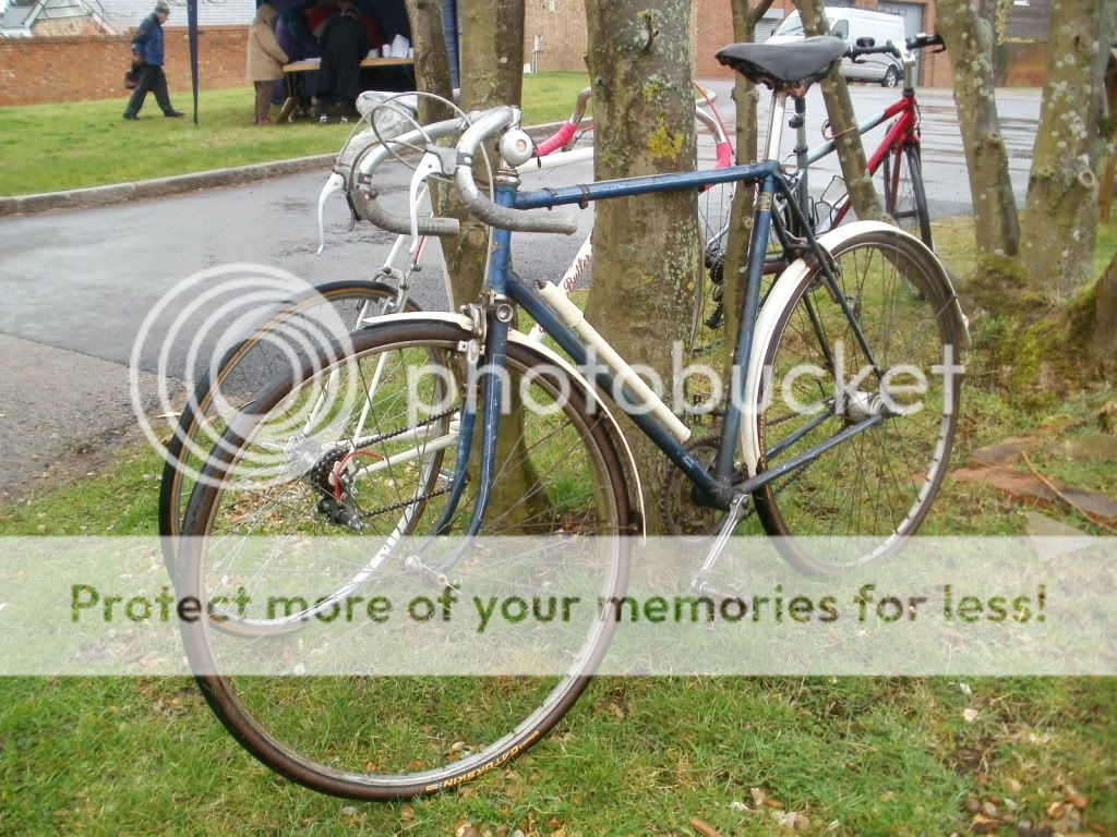

What a lovely bike to ride the Claud is, smooth, quite and very comfy. Only down side was the gearing is a bit high with 18 - 50 oh and it is now filthy.

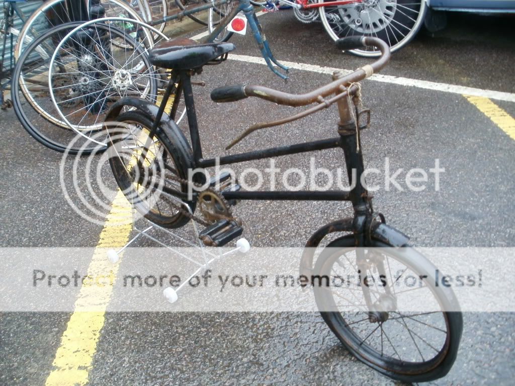

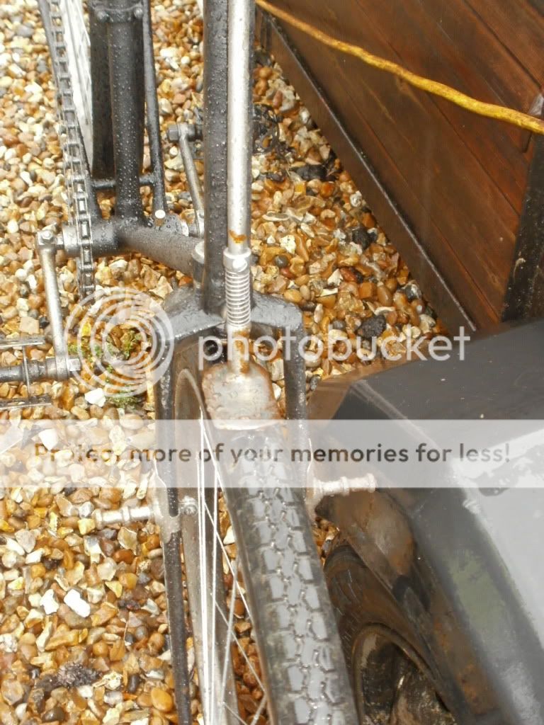

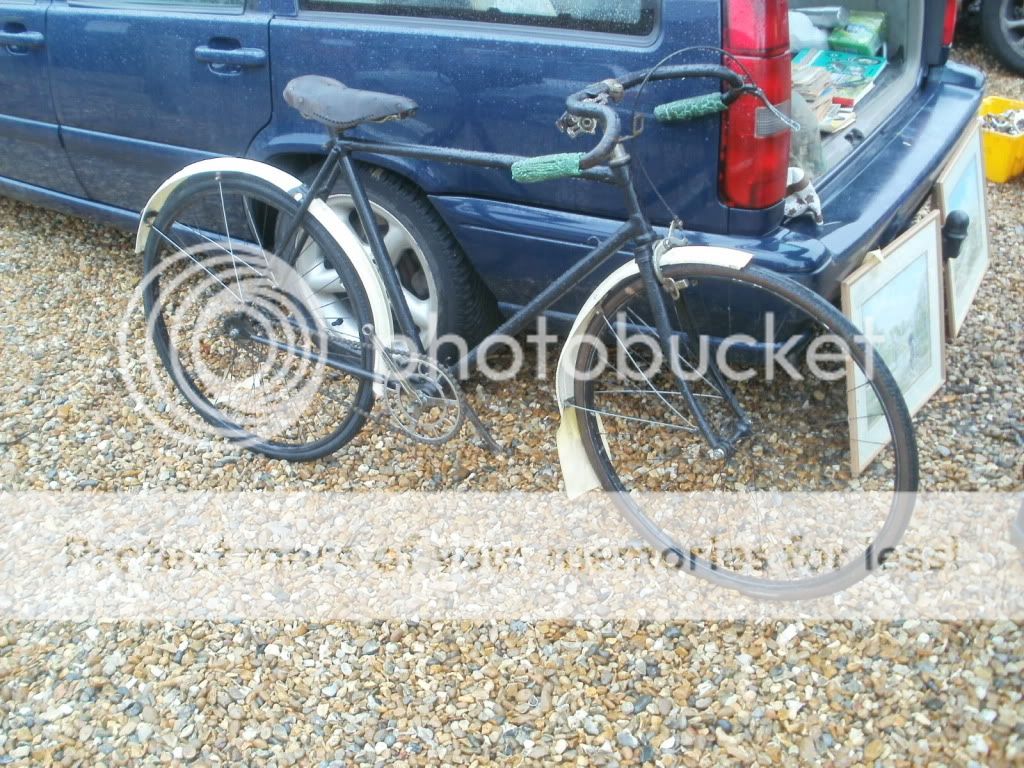

Not the most effective brake ever made! Note the pegs on the forks these are not for stunts as my daughter suggested but to put your feet on going down hill with the fixed chainset flaying round. Scary stuff.

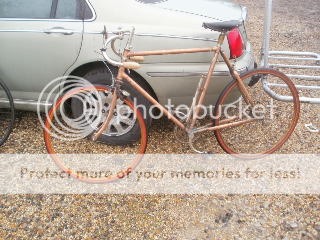

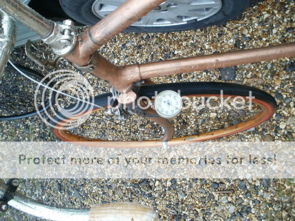

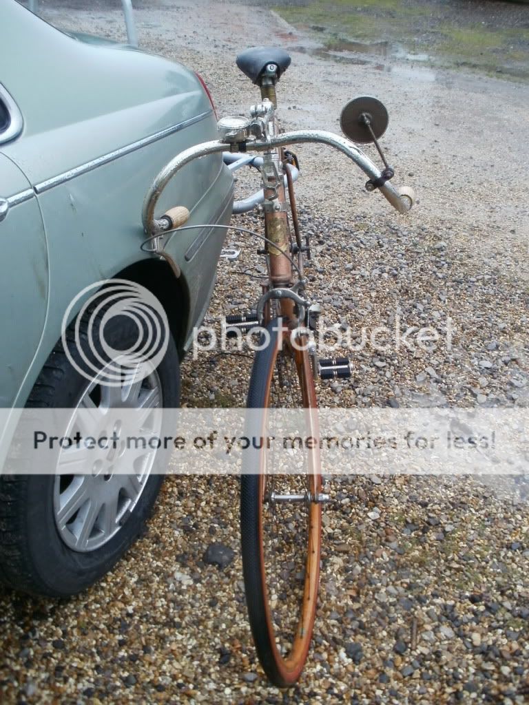

I just LOVE the curved cranks on the gold coloured bike. Pity about the rain. If you'd have been playing cricket or tennis they'd have called it off :roll: :wink:
Ned
The Gold coloured bike was made from Copper tube and lugs. I tried to find the owner to get further details but he must have been in the Pub and was gone when I came out after a warming cuppa.

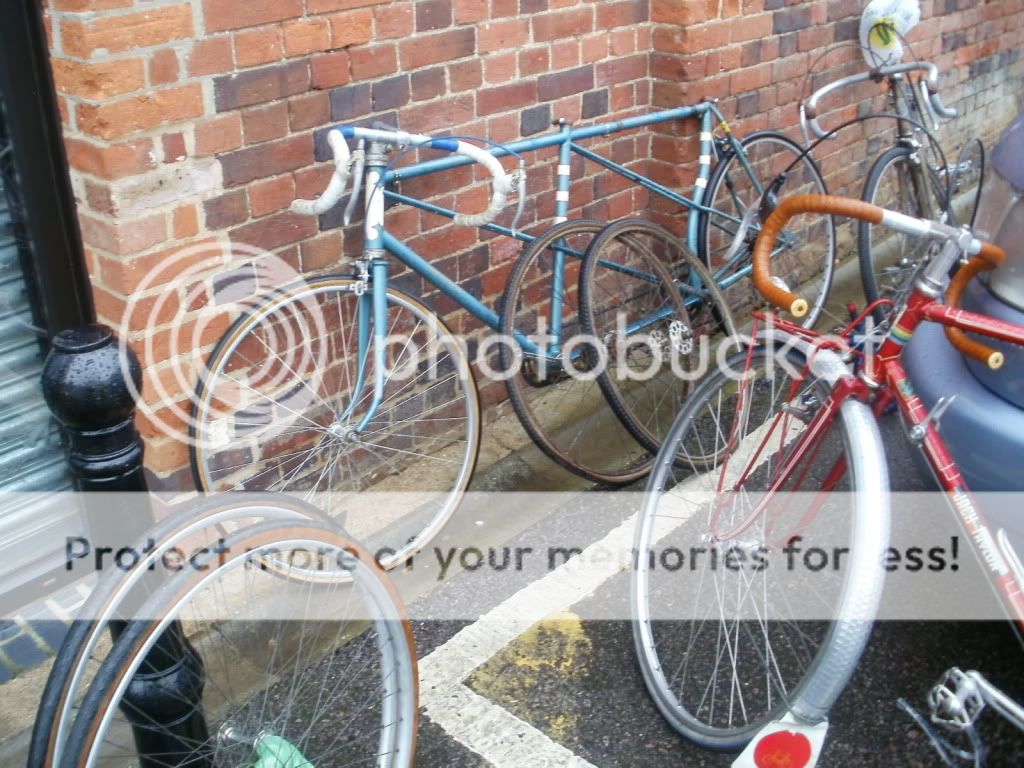

Do you think this frame would be as stiff as a modern Carbon job? Look at the lack of Head tube.
