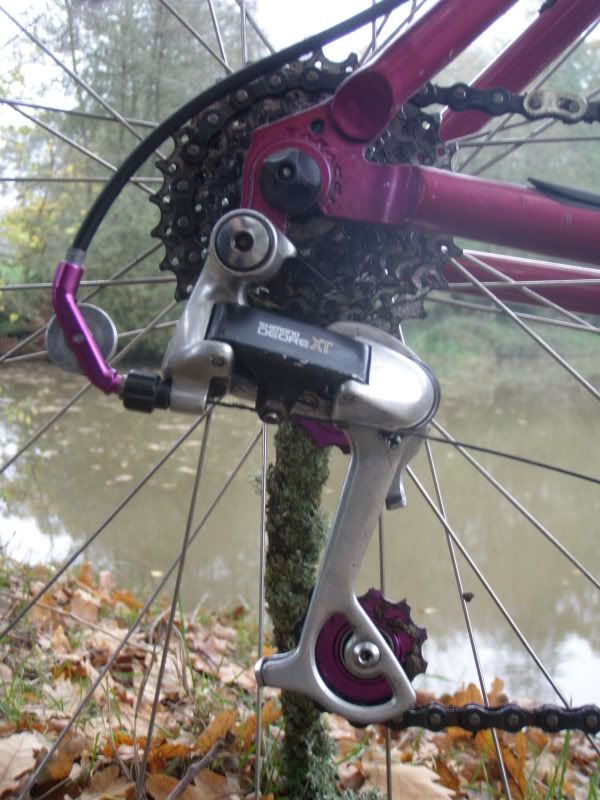

The one problem I am having with the build as pictured is I simply cannot get the rear mech to index properly :?
I put that down to the fact it's an 8-speed cassette...
...that even with the 'hidden' eigth position (which isn't actually a 'click' at all...) will not change cleanly and slips under pressure. I had to quickly flick the shifter to friction mode to get anywhere.
I think I'll get myself a new 'Sunrace' 7-speed cassette to replace it.
The mech itself I got a little carried away with :oops:
The jockeys were well worn (not the only problem I found with it...) so I took the opportunity to replace them with the 3DV alloy wheels in the photo' - 10T upper, 11T lower (I did have 11T in both but it put the chain too close to the big cogs!).
I also had an original Avid alloy Rollamajig in purple but I left it on my Kilauea that I rebuilt for my daughter - because I didn't envision needing anything purple in the foreseeable future! Luckily the purple Crud Cog Hog came up on eBay so I paid a stupid price to ensure I got it!!
The sharp-eyed out there will notice the dodgy bolt on the cable clamp; that arose when I went to tighten the allen nut and found out that the thread was stripped! The perils of trusting a sellers description on eBay I guess :cry:
I think I have a spare removed from an old mech so I shall have to have root around in my 'box-of-bits' and see if I can find it??

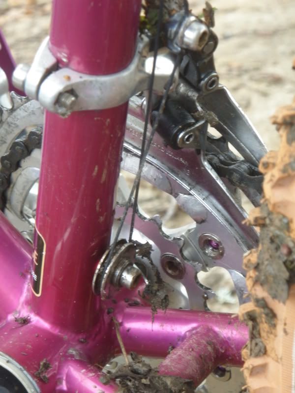

The front mech I could have used a top-pull, but then I would have had a redundant roller...
...which would have been a shame after all the effort it took to free it up from under god-knows how many years' layers of rust!
Anyway, that's how it came from the factory so that's how I wanted it - n'owt wrong wi' a bit o' authenticity arter all :D

You're spot on about the bit of tubing through the metal noodle, btw. Mine originally came with a short length of black plastic tubing inside the metal (still using it, actually). Interesting route on the bottom pull mech, btw (and I agree 100% about having the roller and not using it, had to get a hammer to allen bolt on my roller on mine this morning to get it out) - seem to remember always running mine down the other side of the roller - thus avoiding the cross over wire - guess it depends on the mech you're using though. :)

:lol: Yes, I thought I'd get a comment or two on my choice of cable routing for the front mech!
The thing is, I tried it both ways and (comparing it to my under-BB routed frame) the cable seemed to fall more naturally to the right of the roller and 'looked' better for being parallel to the seat tube... :roll:
...looks better from this angle :wink:
