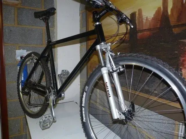

i fitted the girvin fork, it did ride loads better, still has the bar dropping feeling when cornering but by comparison with the carbon fork and the handling of the white ali O it's so slight that i think i could happily ride it! . . . maybe . . . i am gonna try a 10mm shorter stem and a riser bar, see what difference that makes.

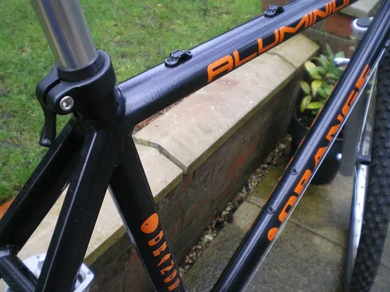

i got the bike back from GA's yesterday where it has been in as a lay by job for the toptube cable guides.
Ben from Orange sent me a bunch of them, they needed to be riveted on and they are designed to run an outer cable all the way to the rear brake so with the new cable seat clamp that meant i can run canti brakes no problem.

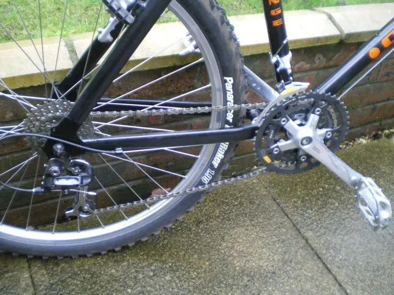

also i have changed the chainset and b/b for an older dx set up, i never really liked the 4 bolt lx chainset and i think this suits the bike better.

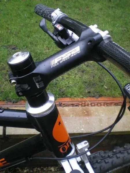

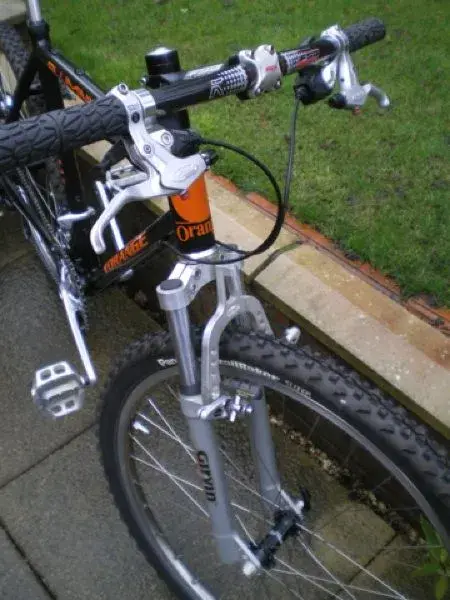

i also want to change the bar/stem etc, i want something in silver to match the newly fitted USE post as i think the black frame needs lightning up with silvery components. also when i am happy with the stem position i will cut the excess steerer off.
i have also fitted the sticker set supplied by Gil M, all was going well till i got a bit cocky fitting the "orange" logo on the non-driveside downtube, it's not that bad but basically the "g" and then"e" have got a slight crease in them. :x

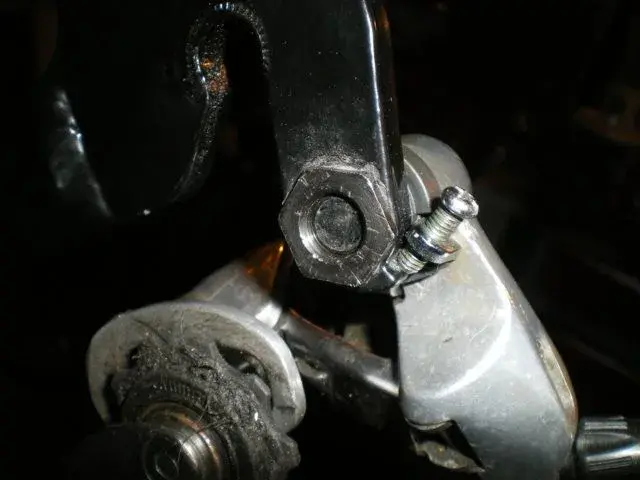

turns out the frame has a helicoil in the drop out, which then came out with the rear mech when i undid it. :x
and will it go back in? :?:
. . . . . . . no . . . . . :roll: :x :x
having looked at it closely though it's a right state in there anyway so i think the best route is to go for the old skool frame saver . . . drill it out and stick a nut behind the drop out.

well i got the frame saver sorted, bit of a faff to be honest but it all works fine.

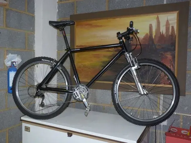

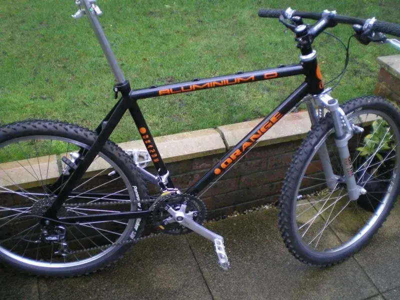

i have almost finished the bike . . . for now :roll:
i still need a saddle and i have used some blue brake levers that will be replaced when i get some silver and black ones, also i only have standard crappy shimano pads which don't feel that powerful so i'll get some new pads at somepoint. also the rims don't match but i have some wheels coming from Wutangled to sort that out, but this evening i wanted to get the rear end sorted and decided to get a few other bits sorted while i was at it.
anyway here's a pic of the frame saver.
