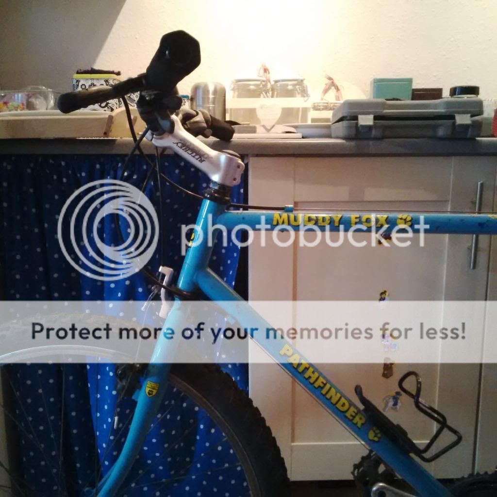

I've finally got around to changing the stem. Thanks again Mr Gumby.

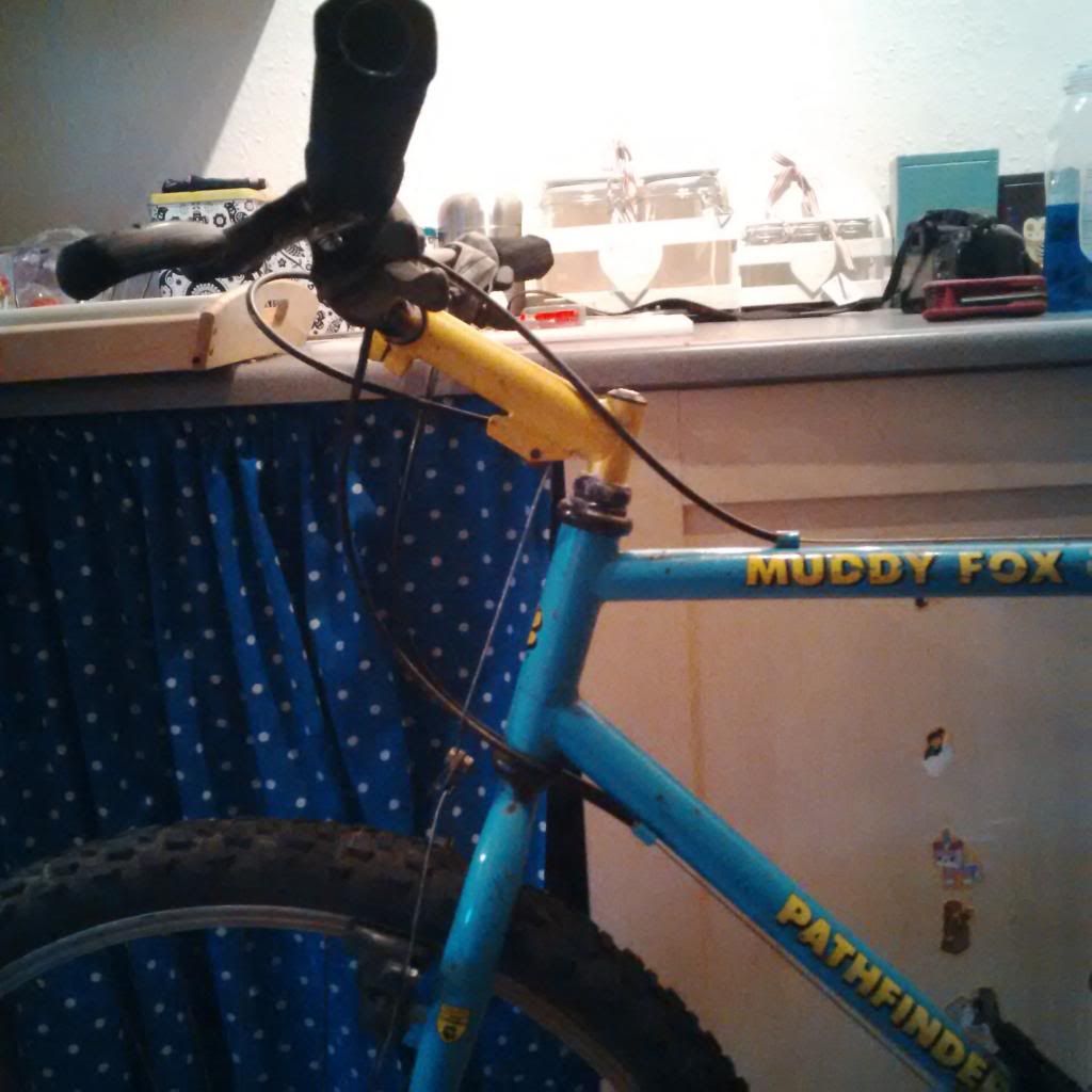

So what was this:
Is now this:
The proper stem has about an inch more reach I reckon, which is good because the bike felt a bit short to me, but I just put that down to being more used to a road bike. I'm certain the bars are not original either - the bars on my OHs Explorer are shorter and straighter, as I think these should be. I probably should have shortened the cable outer a bit too, but I always squash them because my clippers are old, so I left it.
The old ahead converter stem will go on the Trailblazer 700c frame when I've got the old stem out and re-painted it. I have some drop bars for it but they are 31.8mm so I will need a different bar holding bit of stem.
(and excuse the mess in the kitchen)
EDIT - to confirm what the tape measure said - it was a snug fit width-ways in the car. I can confirm that it's now a *very* snug fit. But it does still fit, which is good as it means I don't have to fold the seats everytime.
