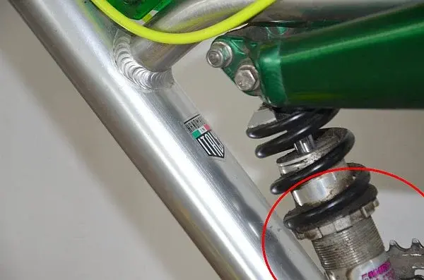

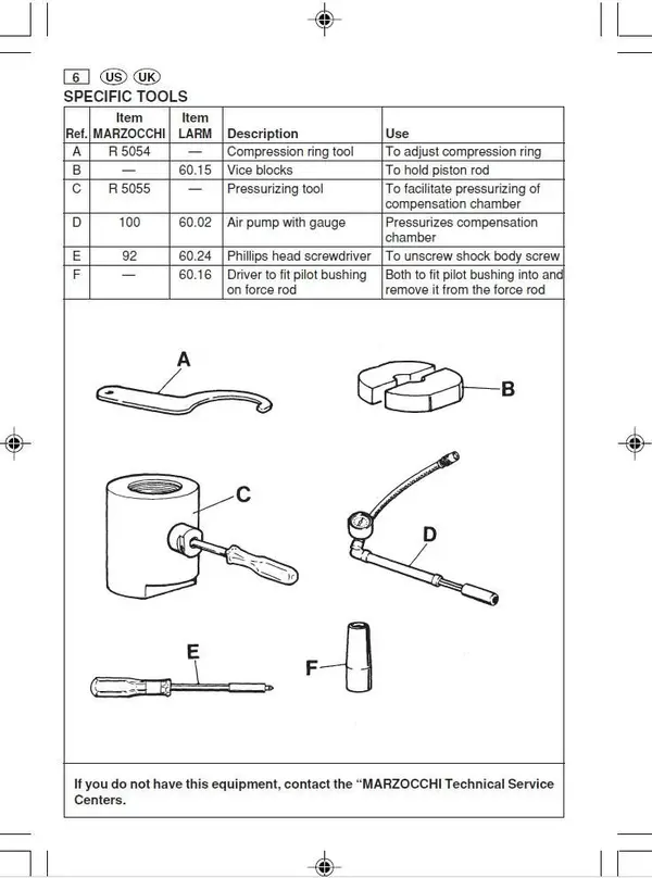

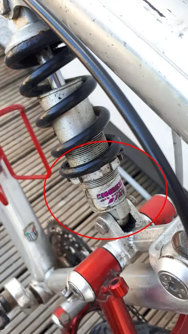

Update about rear shock : It seems to be a Marzocchi C25 or C35. My shock does not have a label or identification marks, I have seen a 'Marzocchi' label on pics on the net from a Sintesi Thruster and a Bromon (added). The shock on the Thruster is a longer one than that on the Bormont. And I found and added the manual.
It is a oil-/air suspension shock. From what I read in the manual you need a special tool to pump air in ( Ref. C, Marzocchi item R 5055, 'Pressurizing tool').
It is something like an outer pressure champer (there is no outer valve) - so this will probably a very difficult task and I do not have seen this before nor I have an idea about :-/
Service kit : MARZOCCHI 850553.
Manual is here.
I have another FoxAlps4 which fits, this might be an alternative.

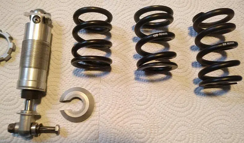

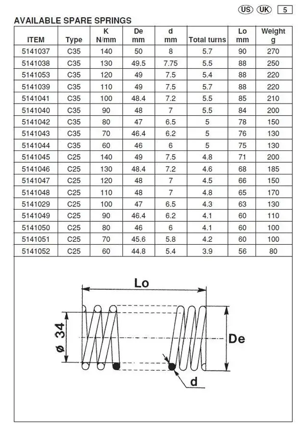

This is from the manual above, it show the various setups for C 25/C 35 and the other picture shows the spring I found in my boxes (left: original one on my Kona; middle: has been mounted know (a bit longer and taffer); right: too long).
Travel :
C25 = 25 mm (1 inch)
C35 = 35 mm (1.37 inches).
Wheelbase (from what I understand and measured this is the axle to axle distance) :
C25 = 135 mm (5.3 inches) - means this is shock is mounted in the Sintesi Bromont
C35 = 155 mm (6.1 inches) - means this is shock is mounted in the Sintesi Thruster

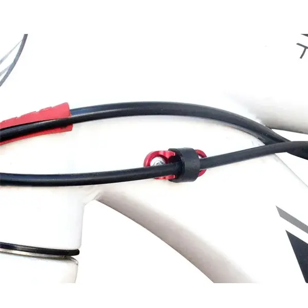

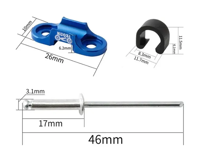

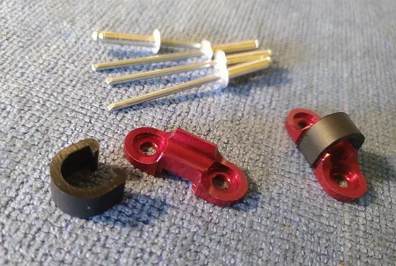

Solution for cable mounts on Verlicchi frames
Just an update on spares : During working on cable mounts I was searching a long time about red anodized cable mount replacements and found some at AliExpress for less €€ - one in a package.
For my rebuild I ended in moving 2 cable mounts from the left back swing (for disc brake lines)) to the center frame, but need to drill it out.
Now I'm also in need to have some open cable mounts to be able to exchange also the back hydraulic line (new pressed Stahlflex - it is also a little bit to short) - it won't fit through closed cable mounts.
So this little wonderparts can do this trick. I received this today - you can order in all colours and the hole - hole distance is the same. You can use the black clip to hold the lines or just use some cable ties. I like it ;-)
Check out AliExpr. for other anodized parts, it is a great source.
