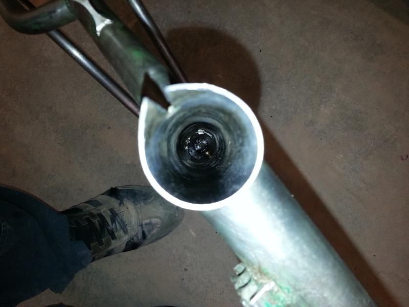

took the frame to work today and had a bash at removing the seatpost, well, what a c**t of a job that was!!!! ive had it soaking in penatrating oil for a few days and even added more when we got it into the workshop and in the vice (mines broken, please santa :) ). after a few pull n pushes the post started to spin freely, but only came out about 7mm. I was dripping with sweat at one point and nealry gave in but we filled the tubes with oil again and went for a brew......as you do. came back after 30ish minutes and i had another go...........hey presto it started to come out again, left after 2 mins of spinning and pulling it removed itself!!! happy days. looked down the tube and there was no obvious reason for it not coming straight away, possible rust binding? i know the frame got REALLY hot during the removal haha. the post was already bent and ive properly crushed and mullered it now so a new 26.8 will be ordered in the new year.

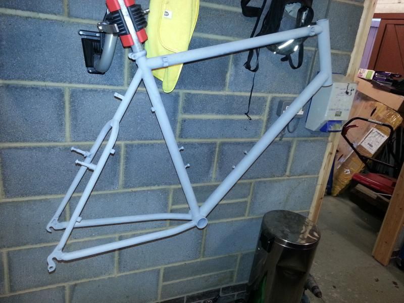

small update, frame has been primed to stop any surface rust over the holidays

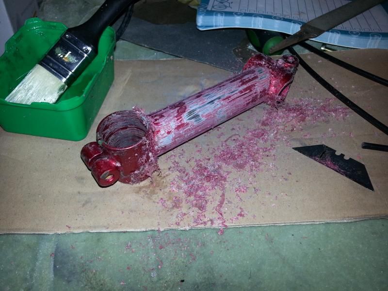

when i have more time, primer and paint et ill give it a proper going over. the bars and stem ive purchased arrived, bars were silver anyway so a quick rub up and theyre in primer as well, stem is er.....getting there
