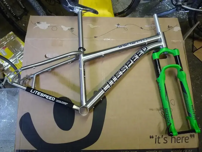

my first 29: litespeed cohutta
danaroby00
lot of interest around these bikes and since selling a good part of my collection and found a good deal I didn't resist
frame and forks arrived and lot of parts on the way, still a big doubt around the right wheelset: xc or trail, custom or complete set from the main brand.....

BobCatMax":gmva6ail said:
frame looks small? or is that just to make room for the big wheels :D
yes, size is small, for 1.7 tall biker usual to short 26" bikes
basically same dimensions of a 26" medium size (wheelbase and top tube lenght) , head angle around 69° with the 120mm forks

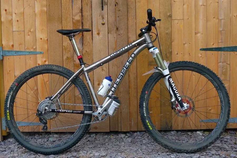

wowwww!!!!!!!!!!
basically same concept I have in mind
monoring 1x11speed, eccentric bb to lower the bottom bracket for better handling and relaxed head angle with a 120mm forks ( my frame is the small with geometry 1° more relaxed than the other size, with result of 69° with the 120mm reba I have installed)
still to decide about wheels, probably a trail model, not pure XC to be more safe
unfortunately the weight of the frame is quiet consistent and my budget bit limitated, so I think the final result will be around 10.5kg
