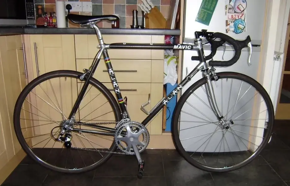

My carbon RR bike.
Lovely bike and a great build too. I'm still not 100% sold on the starfish crankset but the rest of the gruppo is beautiful.
Out of interest, would you consider selling the Mavic QRs? I bought a wheelset recently with Mavic 500 hubs and the QRs weren't provided. I've been using some modern Shimano ones so far, which feels wrong, frankly!
Cheers,
Gareth.
Lovely frame, fantastic components, defo an Alan, even if not in name. Agree with previous posters, ditch the decals
Good work fella :lol:
Yes, carbon tubes bonded/screwed? into alloy lugs. Think the main tubes are hollow and the seat stays are solid.
Defo not 'wrapped'.
P.S. She is now 'naked' and feeling a little shy...so no more piccies until her new clothes arrive from 'Alan'...
that is lovely, the chunky mavic chainset looks awesome against the skinny tubing and the match of dark carbon and alloy lugs and parts looks great.
it's also nice to something other than shimano or campag on an italian frame.
8)
Full spec. of the build:-
Frame. 8-tube carbon fibre.
Forks. Alloy, alloy steerer.
Seatpost. Campagnolo 25.0mm.
Saddle. Flite titainium, black.
Seatpost clamp. Unknown.
Headset. Mavic, 1 inch.
Stem. 3T, black.
Bars. 3T Gimondi, 42cm.
Bar tape Bike Ribbon, black cork.
Gear levers. Mavic, 8 speed, indexed.
Computer. Cateye Mitty 2.
Brake levers. Mavic, aero.
Front wheel.
Rim. Wolber TX Profil, 28H.
Rim tape. Unknown.
Inner tube. Unknown.
Hub. Mavic 501, 28H.
Quick release. Titanium, bolt through.
Spokes. DT Competition, SS double butted.
Nipples. Brass, chrome plated.
Tyre. Continental Supersport Ultra, 23mm, folding.
Rear wheel.
Rim tape. Unknown.
Freewheel. Maillard 12-21, 8 speed.
Drivetrain.
Crankset. Mavic, 42-52.
Bottom bracket. Stronlight, titainium axle, square taper.
Pedals. Time, Classique.
Chain. Sedis, silver, 8 speed.
Front mech. Mavic.
Rear mech. Mavic.
Gear cables. Unknown.
Brake callipers. Mavic.
Cable/outer. Shimano inner/outer.
