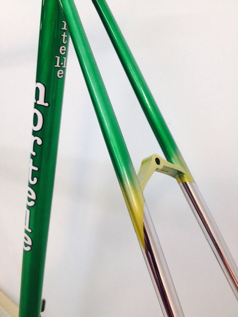

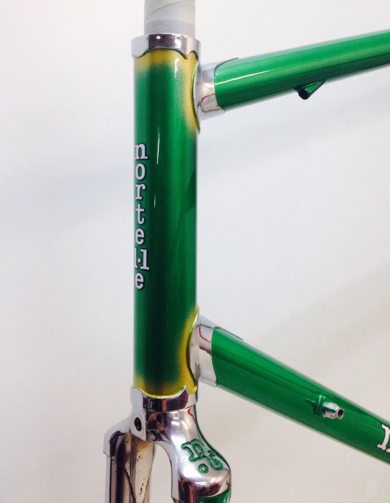

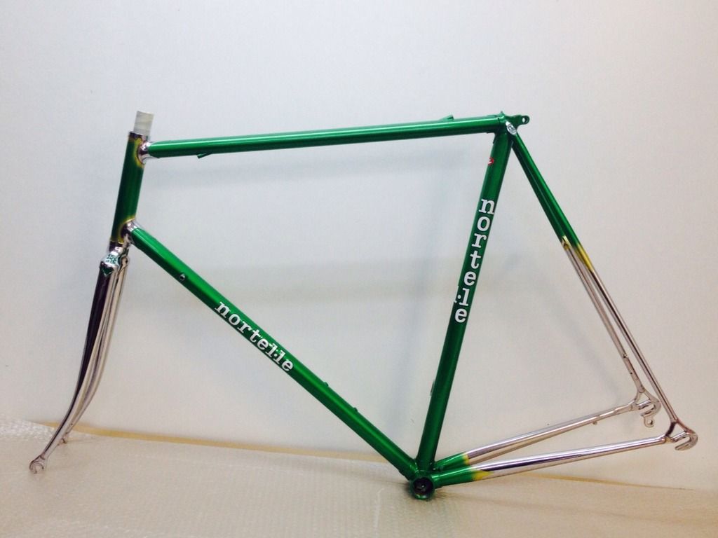

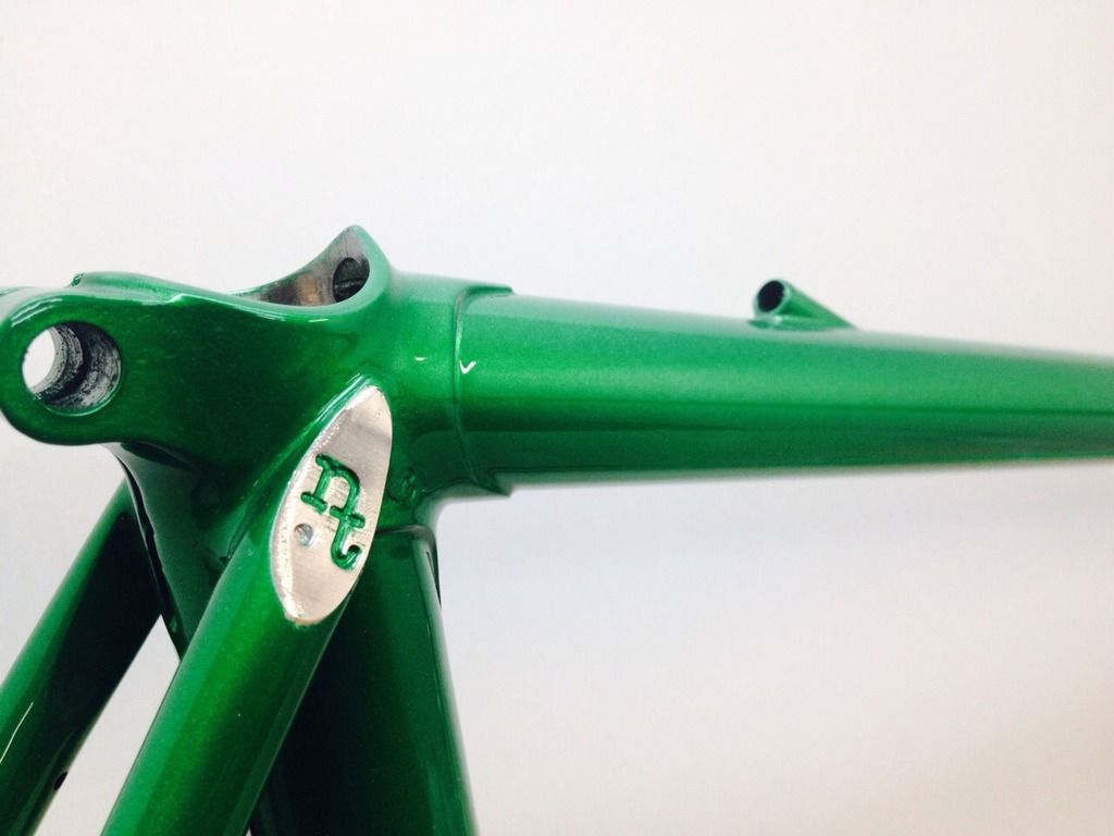

Well, it's taken over 2 years since my last post, but this frame has finally got it's new coat of paint! :shock:
I only have a few pics sent to me by the painter, I can't pick up the frame itself until next week. I have all the parts (and then some, I've been keeping my options open!), but the build will be more or less all campag.
