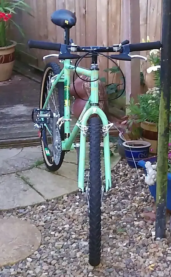

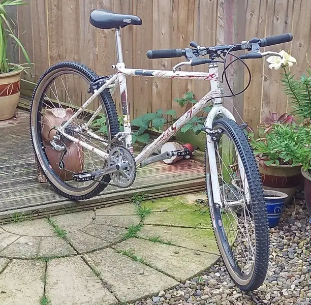

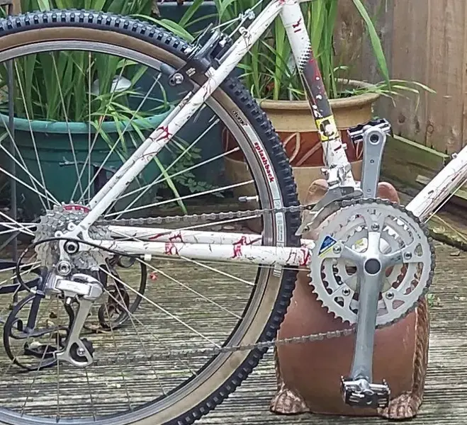

Switched my attention today to the 89 Explosif and got cracking getting the drive train on and all set up :) The only things i've left off are the new HG70 cassette and chain,i'm going to wait until i've had the new Deore ll hubs fitted before doing that part.

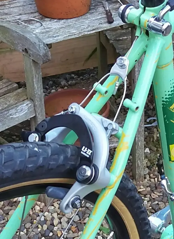

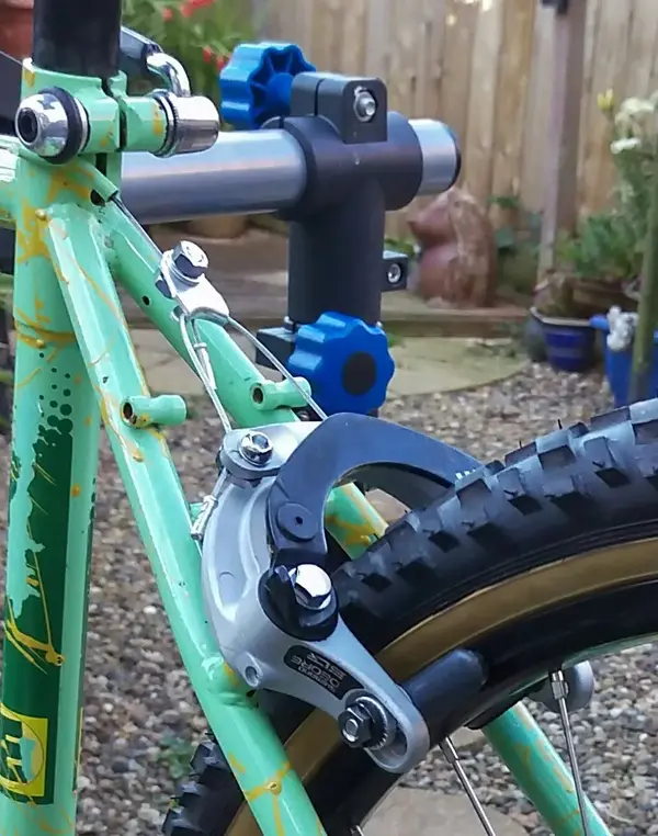

Next stage to complete is getting the brakes on and set up properly,any tips on how to get the U-brake set up properly would be greatly appreciated because i've never tackled one of them before :? All the instructions basically say is bolt them down in the open position :|
Here's a couple more photos of the progress and spec of the bike.
Spec:
Stem: original Brodie ICR
Bars: nos Tioga Tange Prestige
Grips: original foam version
Headset: Tange CD
Saddle: nos Avocet Racing
Seatpost: nos Deore XT
Seatclamp: nos Deore XT
Shifters: nos Deore ll top mounts
Front Mech: nos Deore ll

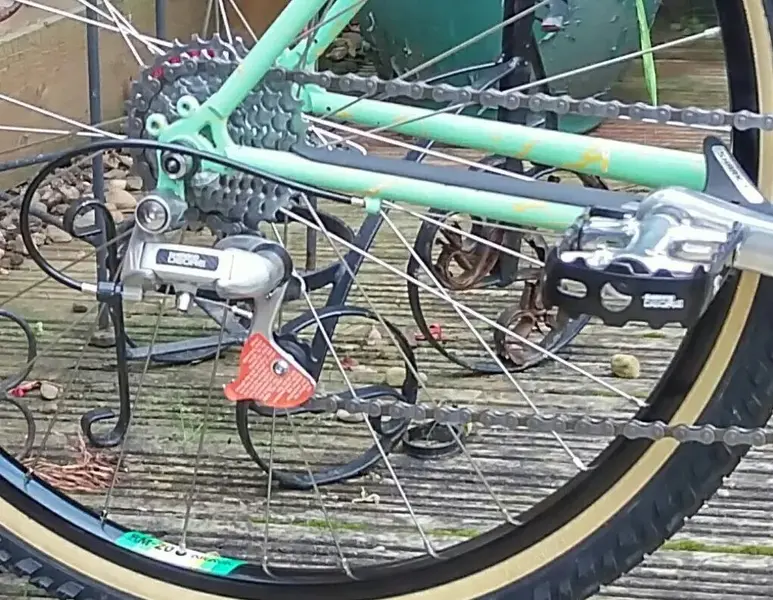

Rear Mech: nos Deore ll short arm
Gear Cables: nos Shimano SIS

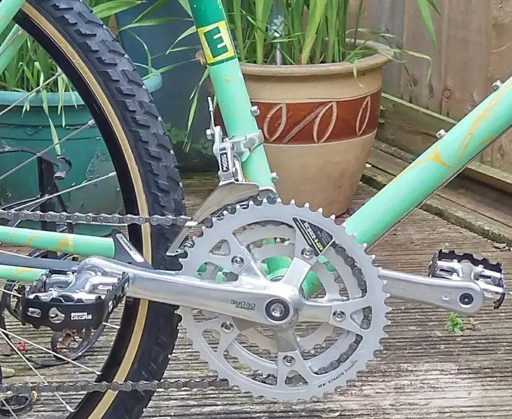

Chainset: nos Deore ll
Pedals: nos Deore ll
Brake Levers: nos Deore ll 2 finger SLR
Cantilevers: nos Deore ll SLR
U-brake: nos Deore ll SLR
Brake cables: nos Deore ll SLR
Tyres: nos Tioga Farmer John Cousins
Rims: nos Araya RM20 black anodised
Hubs: nos Deore ll (to be fitted)
Cassette: nos Deore ll HG70 (to be fitted)
Chain: nos Deore ll (to be fitted)

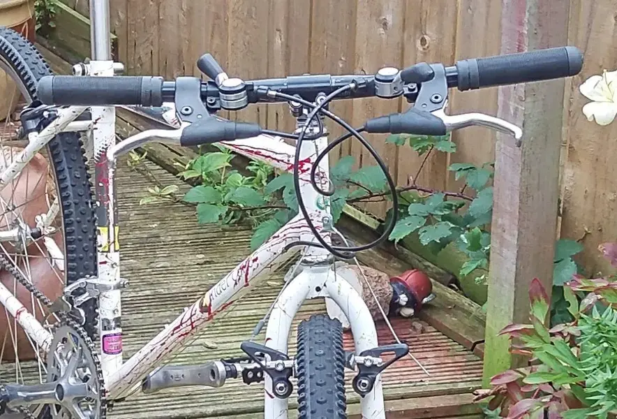

:D just need a new Denton's cycles sticker for the finishing touch. I found out that an ex employee has been allowed to use the brand name and original Denton Cycles logo. I'm going to email him to see if he can reproduce the bike shop sticker for the downtube and get 7 of them made.
A little bit of fine tuning to the brakes and gears and it'll be ready for its group photo shoot.

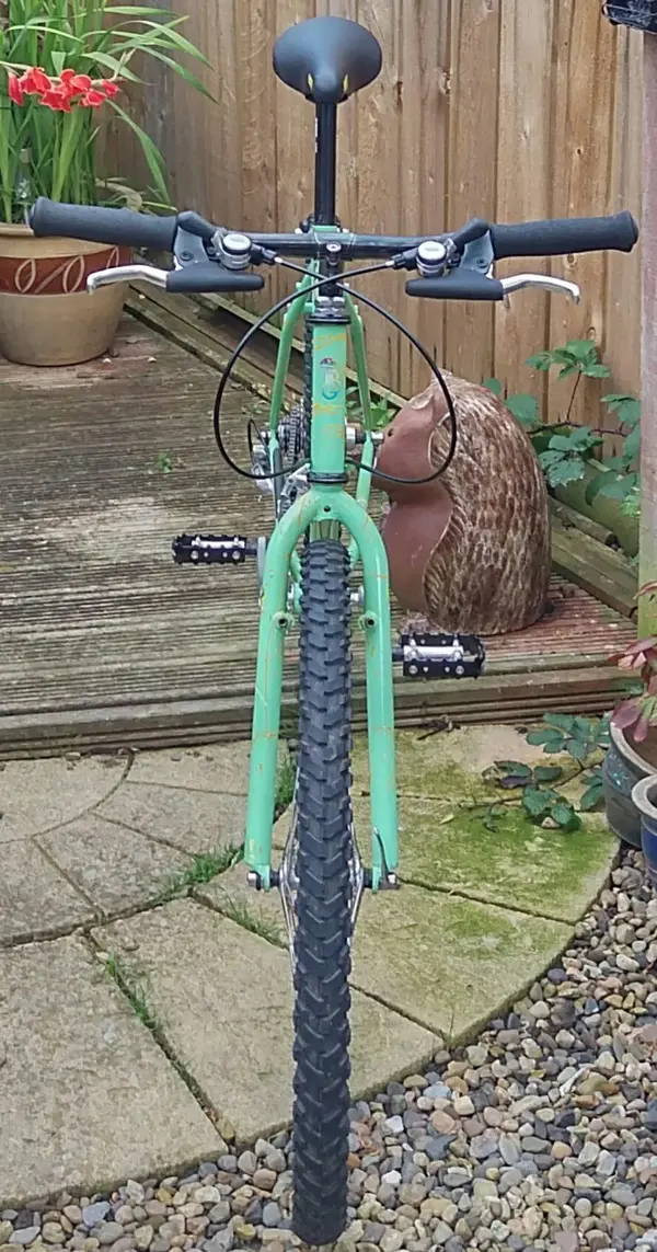

You'll find it'll shift more smoothly with the cable crossed on the down-tubes. At that angle the cable rubs more on the guides, especially on the rear mech routing.
I think it's everyone to their on when it comes to cable routing,i've ran the cables in both types of ways and never really noticed a difference,they just change gear as they should.
Plus i cannot be bothered to pull the cables back threw and reset the gears again,they work that'll do for me :lol:
Spanky22b":3d6f32d1 said:
That's true. It's also how they came out the factory (and therefore designed) :wink:
al-onestare":2ag4h4ij said:
Out of curiosity today,i had the time to take both the explosifs out one after another round the block,shifting up and down the gears. The 89 has crossed cables and the 90 has straight run cables and i can honestly say there is no difference what so ever in the way they shift gears,the 89 has nos Deore ll and the 90 has used m-732 XT
From what i remember it might of been specialized back in the late 80's early 90's who done the cross over cables and back then what ever specialized did all the mainstream company's tended to copy so it's probably just stuck as the thing to do.
