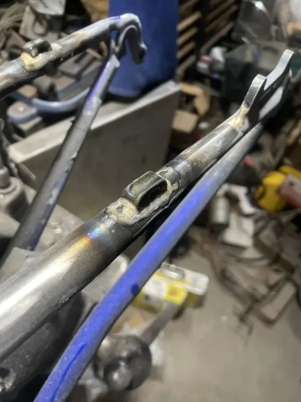

Yep, but I might end up adding it to both sides, as it’s a flex stay design. I wouldn’t want one side to flex more than the other. It might mess up these hi-tech kinematics 😂
It does seem like the dropout joints are under a lot of stress with this design as it is. But i am probably underestimating the strength of the joint.
I’ve measured the seat tube at 29.7-29.8mm… is that realistic for this era of frame?
Trying to find a seat post….
Braze-ons are silver soldered on. Four on the underside of the top tube, four on the seat stays. Nearly ran out of easy-flo….. serious rationing going on tonight 😂
Just got to find some suitable tube to brace the dropout area, a rummage in my scrap bike pile should turn up a frame I can chop up.
I still need to actively look for some 26” disc wheels, not a whole lot on Facebook down here in Dorset.
I’m going to go for gloss white, black everything else (bars, brakes, seat post etc) , black decals. 77FA927F-2A44-450F-9910-D9E23CBA9E85.jpeg E7894C8A-FDD7-4187-A12E-F9D6CA6E7C61.jpeg
