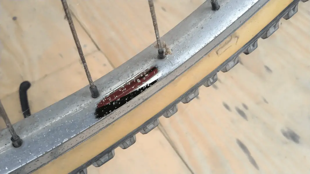

I would be very interested to see inside one of those rims.....as they look very corroded for chrome on alluminium......might also shed a bit of light onto a route to restore them..
I thought th op said they were chromed rm20s? Has that not been confirmed from the spec......or is there really not one :LOL:
If they are steel that would make much more sence as to get chrome on alluminium that bad you would have to be riding it in the sea pretty regularly!
I'm away for a week.....so will have to go by pics I already have.
Wheels...actually the trickiest and worst part of the bike as the frame and other parts will all clean up pretty well I think.
They are Araya RM20s (according to the sticker and they are the correct profile) so unless they made a steeel RM20s then these are aluminium which has been chromed, thats also bourne out by the lack of rust...this is more like a corrosive reaction/with piting flaking....if steeel I'd have expected rust spots, also under the chrome you can see what looks like dull aluminium.
The Inside of the rims when I changed the tubes were box fresh which was a surprise, no corrosion and original (well looked original) rim tape present....annoyingly I didn't take pics...just of the weird innertube
I think the spokes may have also been chromed originally, they are rusty....but some glimpses of shine.

Thats the reason i was interested to see the inside....if chromed the inside is probably chromed to, especially if done as an after market job.
I agree that if they were steel, with that amount of corrosion on the chome i would expect to see a lot of rust marking coming through.
They have obviously had a hard life and been stored / looked after none to well! As chrome over alluminium is normally less likely to corrode as the base (being zinc coated to get it to stick) is pretty robust.
Its either re-chrome ....try Vehicle and General in Bedford....they are superb or you could try cleaning them.
Coke, salt, flour paste and alluminium foil........
They are chromed inside & clean as a whistle...nice to see what they must have looked like originally....so seems no moisture got in there by some magic.
I've cleaned with foil/WD40 and 0000 wire wool, they have come up much nicer but some areas are so pitted theres not much to be done, not tried coke, alst, flour combo!
Spokes are trashed....i can get them back to silver with effort but they are scabby.

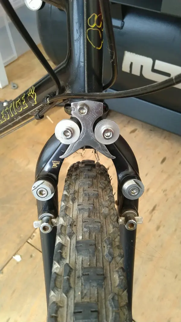

Has anyone ever seen these roller cams in black before....I can't find any images on the net, just the silver Cunningham style ones....which are also a different shape.
