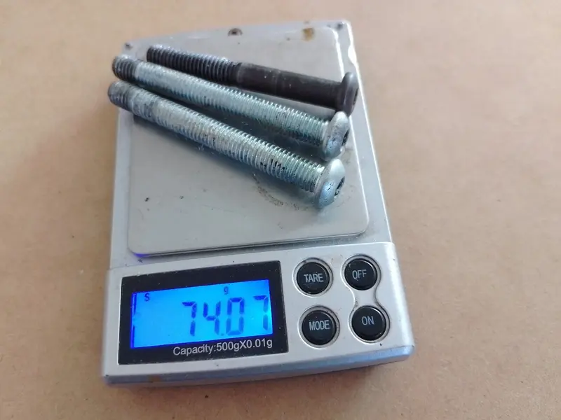

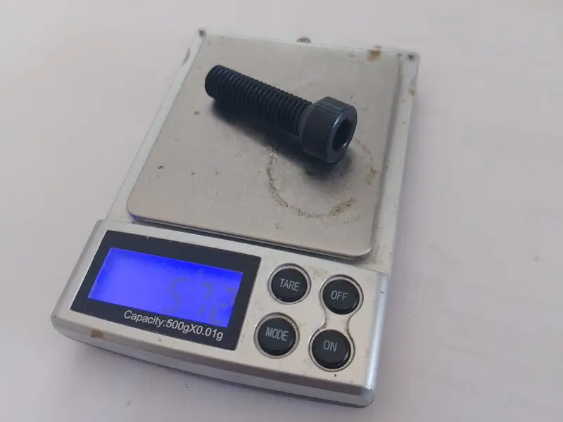

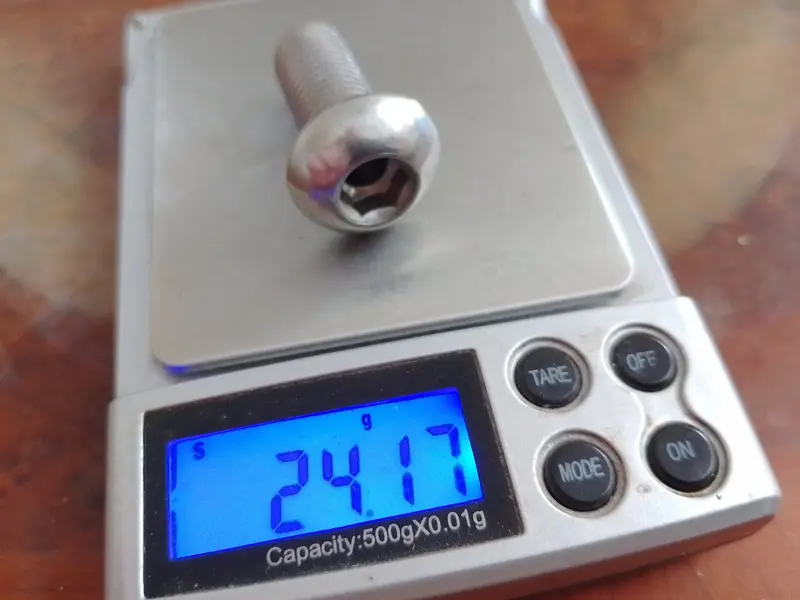

Next up, some lighter bolts. The two main pivot bolts get a bit rusty and so I'm going to replace them with hollow stainless steel bolts.
These two bolts alone save about 15 or 16 grams over the original bolts. I think they'll be strong enough (I hope🤞🙏🤪).

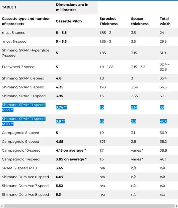

Given that the limiting factor of riding uphill was my gearing not suspension bob as I expect it to be, I decided to change the gearing to make the bike more useable...
Road and MTB stuff is not meant to be interchangeable beyond 10 speed.
I say bugger that, and got a road bike cassette (cheaper & lighter).
So I changed the cassette to an ultegra 12-25T 11 speed one, and I put a 32T chainring on.
I also have an 11-23T that I may use once I start taking it to proper downhill runs.
I just got some XT 11 speed shifters.
The good news is that it works! It's meant to be out by 1.6mm over the length of the cassette.
I don't know if it's the full length housing compressing and making up the difference or what, but I'm going with it.
  • Screenshot 2023-07-29 at 21-36-15 Bicycle cassette (rear chainrings) standards BikeGremlin.webp

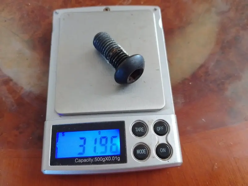

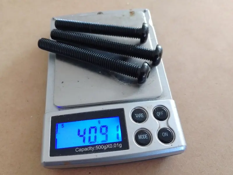

Anyway, some new bolts arrived today.
Sometimes it's nice to have things to look forward to.
These are for the shock linkage.
Twenty-something grams lighter there.
Probably not ideal replacements as one of them doesn't have a flank/shoulder as the original does, but whatever.
(I didn't actually see this until I removed it today, oh well😳)

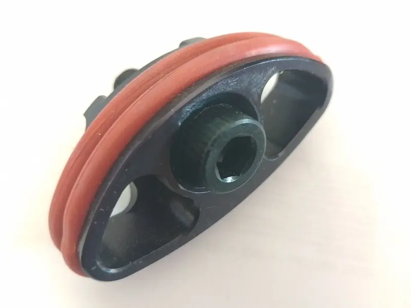

I am also getting a lighter steerer tube expander.

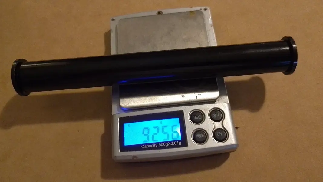

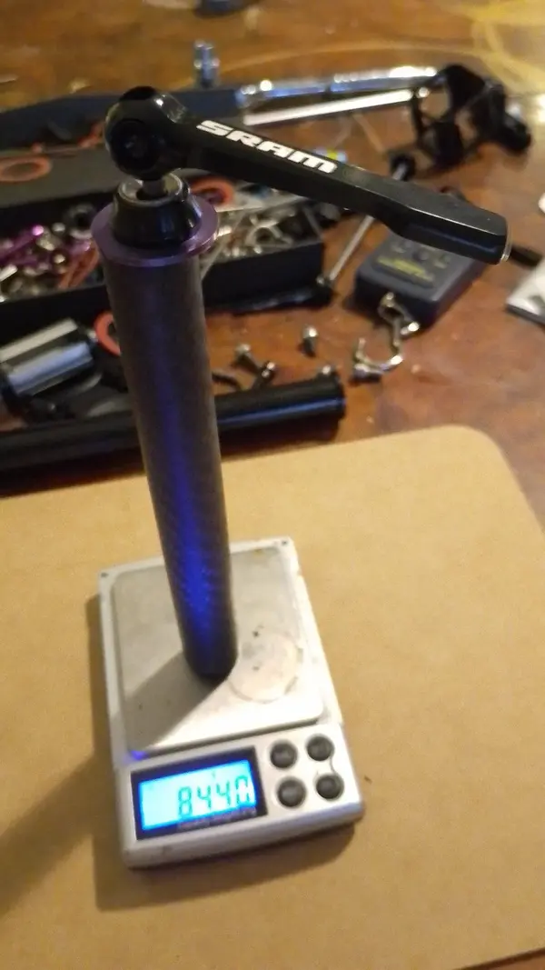

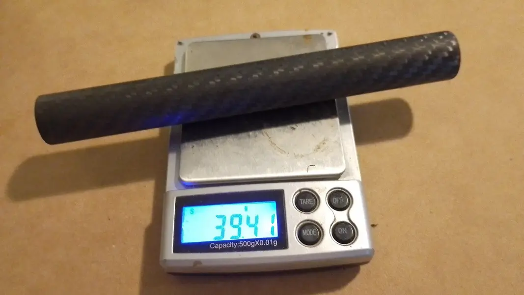

Okay, I finished the front axle.
It's made of a carbon fibre tube with a 3mm wall thickness.
So that's 50 grams lighter than the original Marzocchi 888 axle.

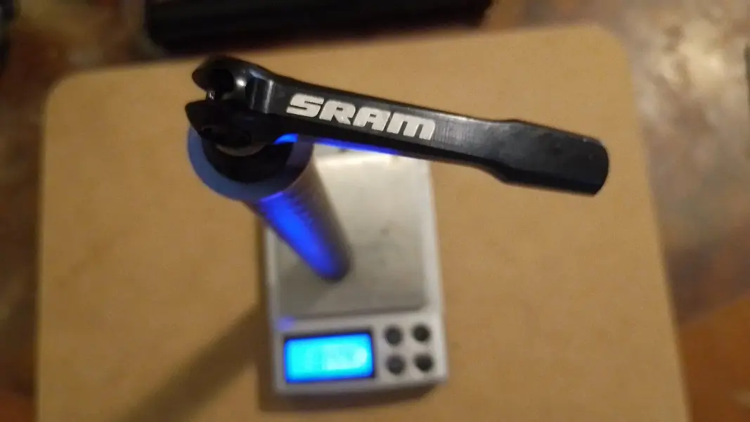

It's always kinda bothered me that this bike didn't have quick release through axles.
I can't afford a new fork (plus they're all for 27.5 and 29" wheels now anyway).
So I fashioned my own (qr thru axle) one out of a spare quick release skewer I had lying around.
I can probably knock another 10 grams off that if I go to a Ti skewer axle.
This is just to remove lateral play in the axle system.
There are four pinch bolts on the fork itself which holds everything together.
The idea is that you do one side up, tighten the quick release, then do the other side up.
The nice thing is that it can be removed leaving just the carbon tube in place.😎
I haven't installed it on the fork yet. Hopefully it works.🤞
I need to find a better nut for it.
The good news is that I put a rockshox quick release thru-axle on the rear too!
Photos of that another time.

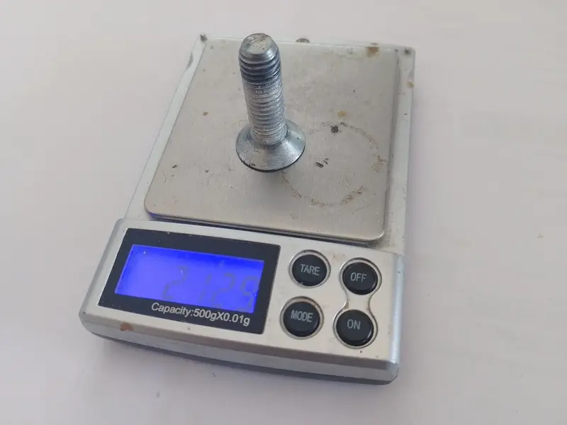

I finally got around to replacing the countersunk M10 bolt underneath the main frame.
This holds on the inbuilt fork stop. It was held in there really tight.
The thing is though, I don't intend to do massive jumps/hucks or whatever with this bike, I'm not that skilled.
So I don't think there's much worry of a high speed crash.🤷‍♂️
And hence I don't think this bolt needs to be that strong.
So I replaced it with a fiberglass-reinforced nylon bolt.
Filed a makeshift 45° countersunk angle on the bottom of the bolt head.
Saved 15 grams right there.
I don't think that's a bad little weight saving.
