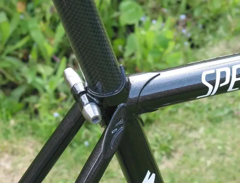

Back to 1988. Made in Japan; grey and white. Lugged Prestige; welded unicrown fork with no lugettes; 'normal' deep slotted cable guides. Serial numbers begin with 8F. Intriguingly, some have an embossed S on the seatstay cap, some raised, some nothing...
