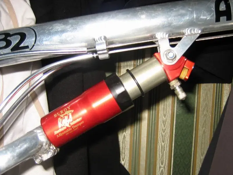

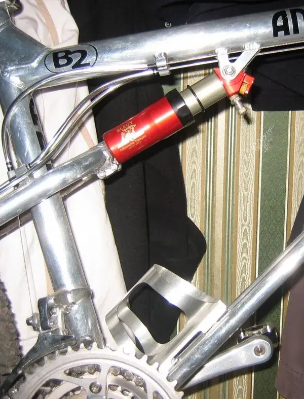

A small update...

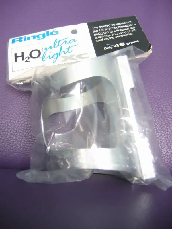

Last week I finally found a NOS Ringlé H2O in silver and old enough, so no etched logo.. :D
...and a better shock... a Risse Racing Elroy... I don't like the color of it, but hey... it's original...
Does anybody know the exact year these dampers came on the market ?

that's the first i've seen an aftermarket shock for a B2 series. I know there were some for the B3s. How's it ride???
Yeah, have to agree I don't much fancy the colour. I'd be tempted to wrap it with something.
I didn't ride it yet.... just installed... perhaps this evening...
I did some other small updates (alu bolts) and just had it on my personel scale... Now it says 10.3kg (22.7lbs).
...near future bring some more alu bolts... by than I'll hang it on a proper scale, since 10.3kg sound a bit to light looking at the parts...

Did you happen to weigh the diff between the stock and new shock? Curious how much a change it is.
Can't remember exactly how much, but my Mongoose Amplifier was around 24lbs so if yours is actually down to 22.7, that's good!

My kitchen scale is broken, so I didn't weigh is, but it feels like the new shock is half the weight of the old one.
Now I 'know' it's about 22.7lbs, I think can be under 22... still have to get an other BB. Now there is a UN92 (or something) in it. I want it replaced by a Ti one... that should take of another 5 oz.. Than some bolts to be swapped and other tubes + maybe other rims should do the trick... :lol:

Sub-22lbs shouldn't be a problem. I've managed to eke mine in under 22lbs with barends. The AMP damper is a solid performing unit if maintained properly, which is a pretty simple procedure, and if you're gunning for light weight it's still lighter than the Risse unit. I've utilized both on my AMP derivatives and have settled on the AMP unit over the Risse.

About the damper... Today I got a first try-out. The AMP spring can get tuned on the roll. That is a big advantage over the air spring on the Risse, but the damping is much better. And the weight... I took out the original AMP and helding in my hand I would say it is twice the weight of the Risse.
I'm not sure yet it I really want to built it into a fly weight since I also want to keep it period correct...
