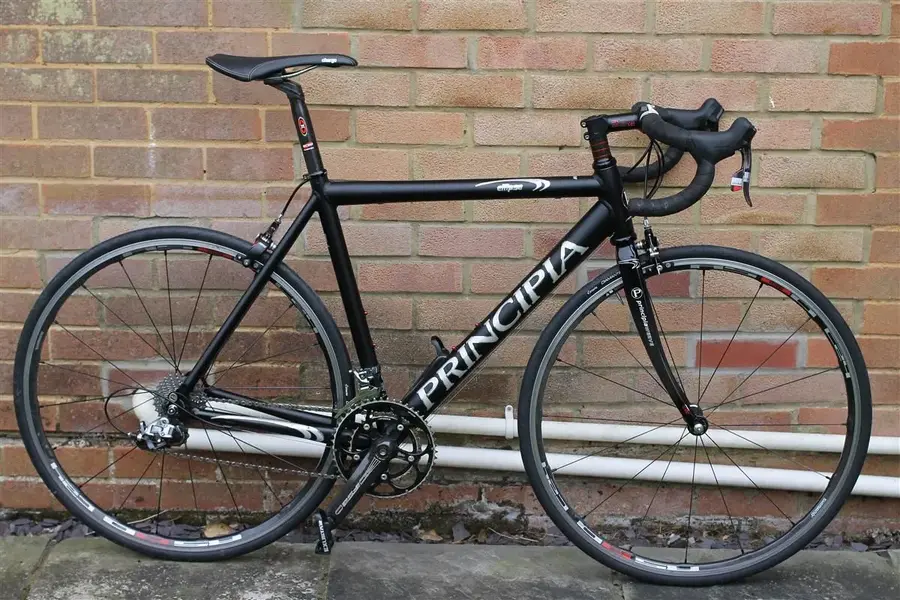

Here's my Rex E. Looking forward to the warm weather to get it out on some monster rides again.

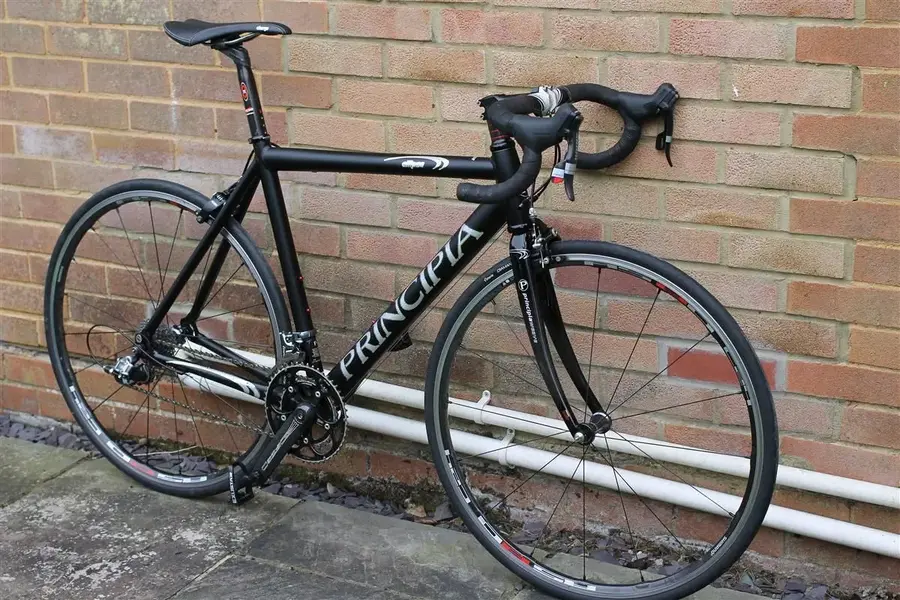

Re: Modern Principia Ellipse SX

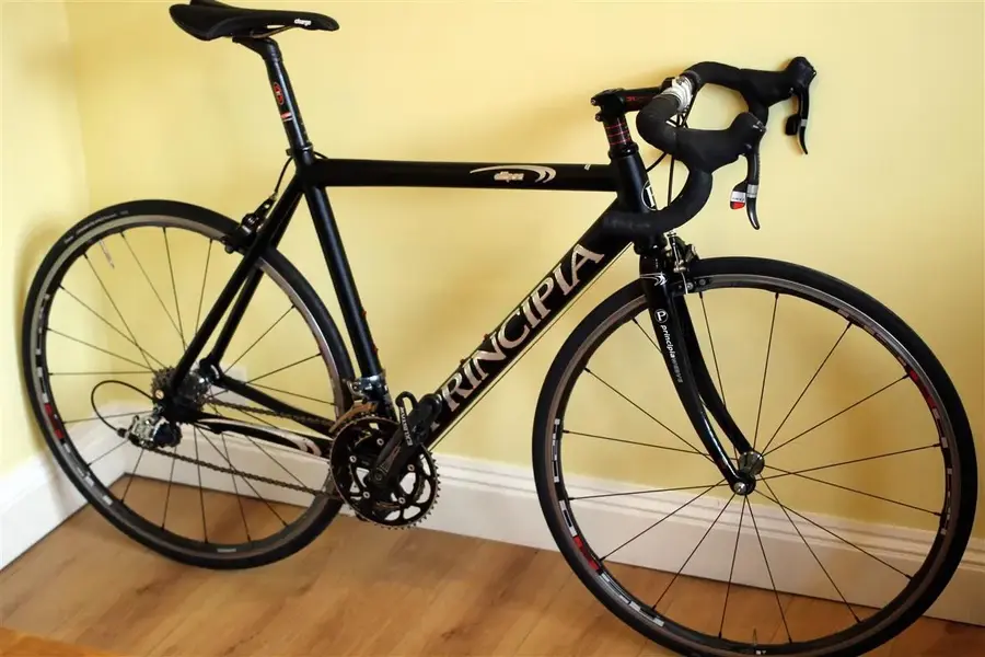

Now it's assembled with 95% of what I wanted to do to it, a few quick photos (some nicer shots to come when I get it in out of the rain...)

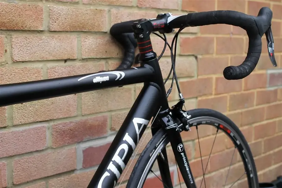

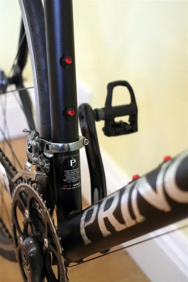

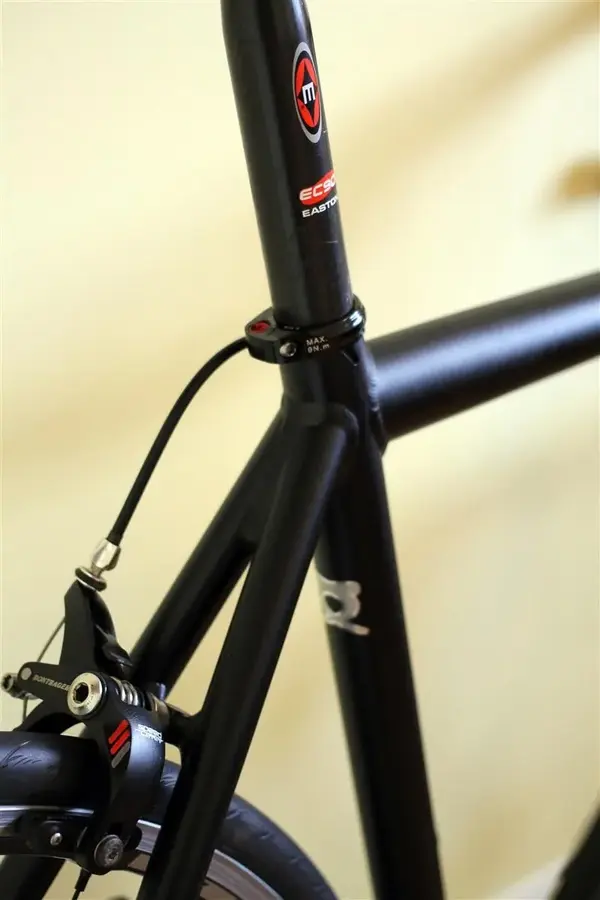

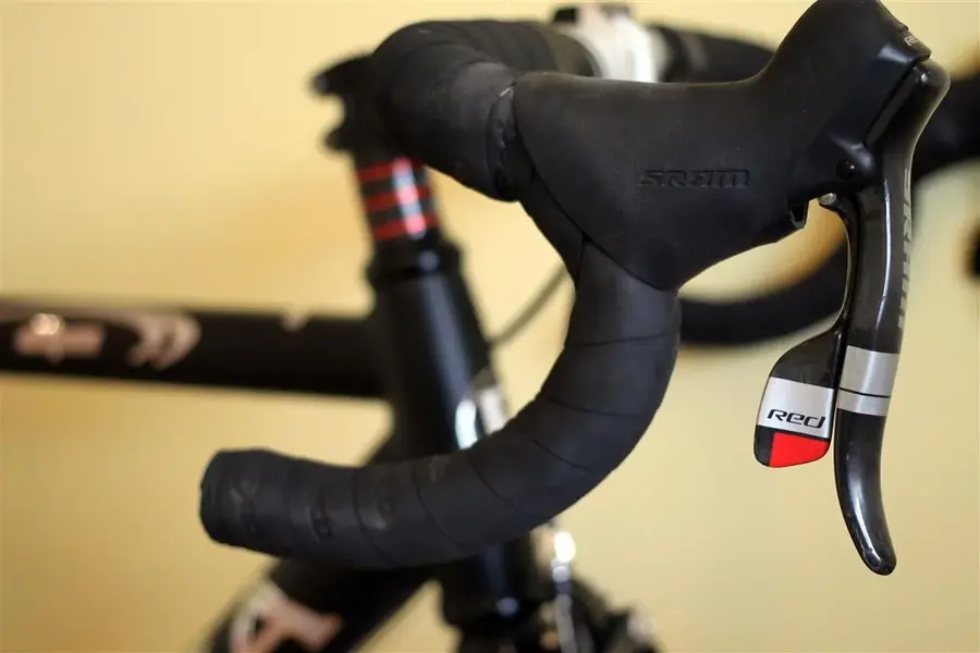

Some final photos... particularly pleased about the way the red bits in the stem/headset worked out!

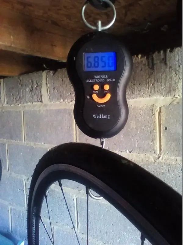

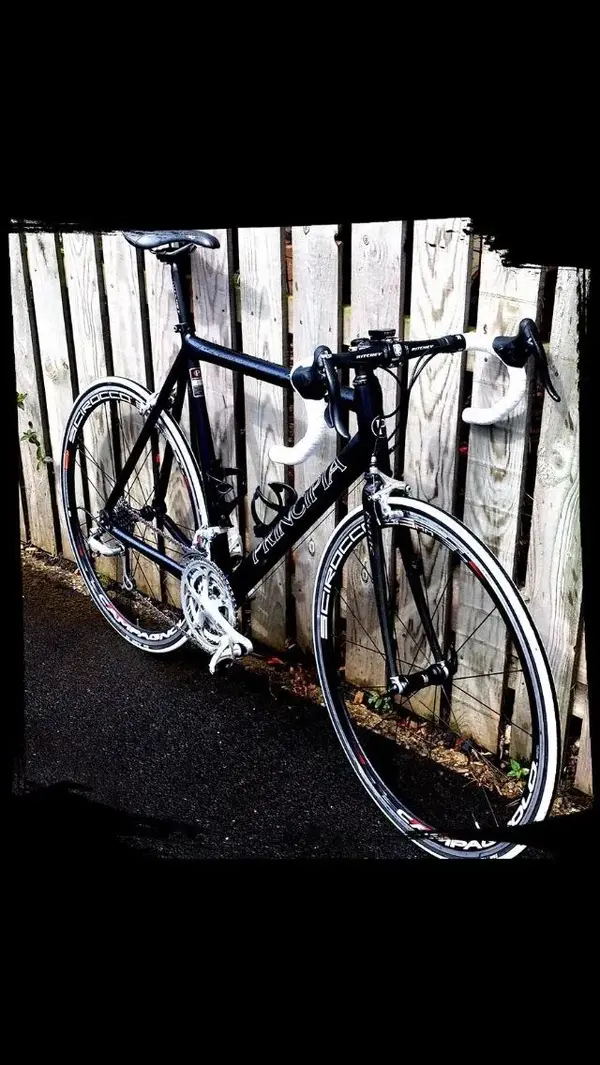

It's been a long time since I updated this thread, but there have been a few nice changes to the Principia in the last couple of years, bringing it into a proper weight-weenie territory (total weight is now down to 6.85kg fully built as in the photo)
Easton EC90SLX fork (around 300g)
Azonic Techlite wheelset (around 1400g)
Bontrager XXX Lite HCM Carbon bars (177g)
HT Components PK01T Carbon/Ti Road Pedals (170g/pr)
Dura Ace 9000 chainset
Syntace F109 stem
A couple of bad quality photos below, better ones coming soon!
