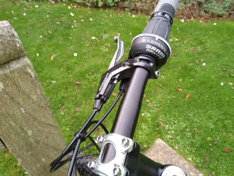

Thank you for the response. My only reason for trying a modern set was curiosity. I found that aside from the SRAM MRX shifters that seem to be a favourite on women's shopper bikes, there are also the SRAM MRX Comp shifters that look much more like the old SRT Gripshift. They got their first run last weekend.
They're light and comfy in the hand. They shift a little more quietly (apart from the left hand shifter when in one direction, and then it is loud). The main gripe is with the indexing on the right hand shifter though. The top end and the bottom end are slightly out of sync with each other: the shifting can be good at the top end or at the bottom end but not both. (This was with a Deore mech that was spot on with the trigger shifters I removed.) The best compromise is getting the bottom end right and then turning slightly too far to get the shifts into the higher gears, but the steps on the shifter are so close that it's easy to shift to 6 to get 5, to 7 to get 6, etc.
Feb 23 Update: I thought that I would give these another go but with new cables (both inners and outers). And the result? Great! Light, easy, precise shifting, both front and rear. However, they're clearly intolerant of grubby cabling, which is not surprising given the smaller spacing between detents.
