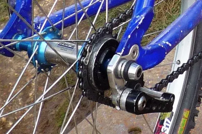

Choose a crank set up and then buy a singlespeed specific chaniring, i.e. no ramps or small teeth like here
Buy a screw on type hub and use a screw on BMX type freewheel.
I'd stick to a cassette hub. Screw-on BMX freewheels aren't all that robust or reliable, unless you spend eighteen billion pounds on a White Industries one. Cassette doesn't look so neat, but it'll last better. And as a bonus, you'll be able to get the sprocket off in a couple of years time :-)

From another singlespeed pervert....don't knock it until you have tried it :wink:
