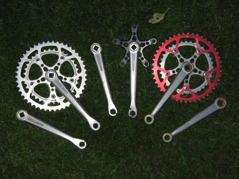

RS2 on the left and middle, RS1 on the right:
