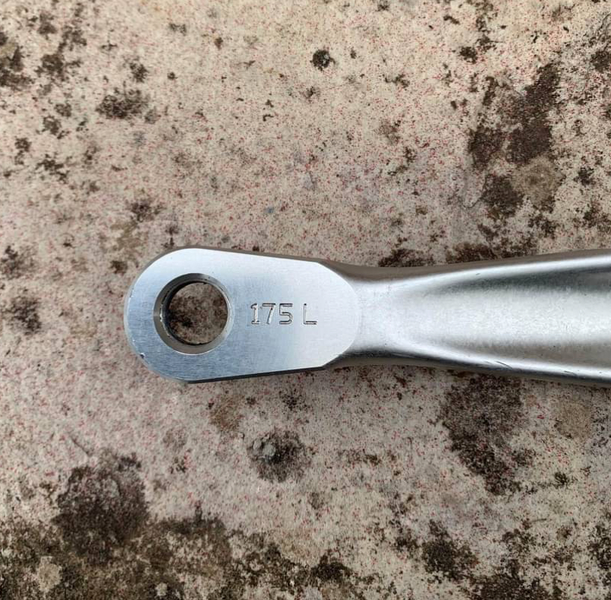

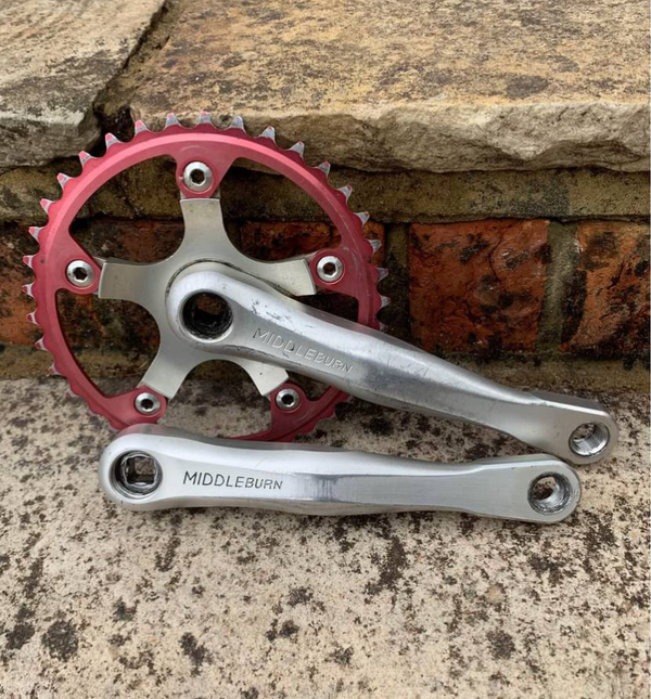

Hi all,
I got these Middleburn cranks recently and I’d like to tidy them up a bit. How’s best to do this to maintain the original finish?
and a side note, which middleburns are these and what sort of age?

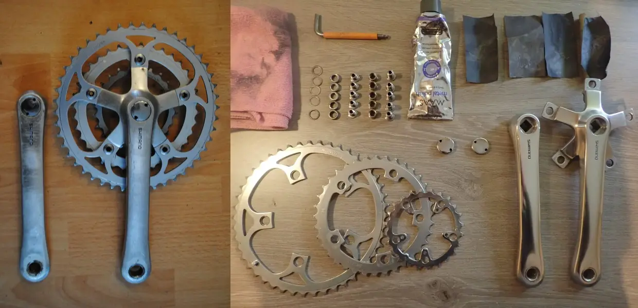

Polishing with wet and dry works well.
It removes all of the original finish which is the only way to go when they are showing that kind of wear.
Once the original finish is compromised I prefer to aim for a mirror finish, as this will offer the best protection against future corrosion.
A coarser grit will leave a more satin finish.

Thanks for the replies everyone! I’m not too bothered about getting them perfect. I’m wondering if taking some fine wire wool or scotchbrite to them would knock down the scuffs then a rub down with T-cut will give them a decent finish.
I don’t really want them polished, I prefer the brushed look anyway…
