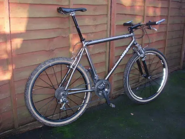

Mirror polish the frame, Gold decals, de-Shi*mano it, ultra-light all black wheelset gold nipples, gold seat collar, Gold Chris King headset, all black chainset, gold middle ring, gold chain, all other components black.

letmetalktomark":3mbv6av6 said:Agree with cce - too much silver![]()
I think this incarnation is my favourite:

You may be on to something here as it's certainly possible that I've never bonded with the bike because it is a bit small. Still, it's never felt particularly uncomfortable to ride in any of the guises. I might well have to do some measuring. What fork a-c would you estimate is suitable for this frame (I have some other forks although at least two of them would mean a 'none more silver' build)?Anthony":2yihv6q4 said:If you're just talking about aesthetics, the general look of the bike in its current form seems pretty good to me. However in terms of the frame's suitability for its purpose, I have some doubts.
Firstly, there seems to be an extreme disjunction between the immense height of the saddle and the relatively short head tube. If that's a personal preference of yours then fine, but no bike designer would specify a medium-length head tube for somebody who needs such an extremely high saddle, and the end result must surely affect the intended working of the geometry.
The other thing is that I always worry about a retro frame showing a zero bottom bracket drop. That is usually a sign of a fork that's too long for the frame, and with the Pace looking to be set at 90mm travel, it could well be too long. If so, you would need a short stem to counteract that, but in fact you're coupling it with quite a long stem, so again I suspect you're taking the geometry out of its intended working zone.
To my eyes, it looks as though you need a bigger frame, with a fork that suits its age and intended geometry.

Word. Although that brings us to whether your bike fits your body or whether your body fits your bike? Hmmm.MikeD":3iwe1tz6 said:Very tall riders often have what look like terrifyingly low-barred bikes but actually they're entirely comfortable on them.
Yep, that's exactly what I had and, cool as it was, I simply wasn't feeling it - unrealistic expectations maybe? To be honest I'm more disposed to the problem being internal than hardware related.cce":3iwe1tz6 said:i am running a 420mm Pace RC31 on mine, and it's lovely.
