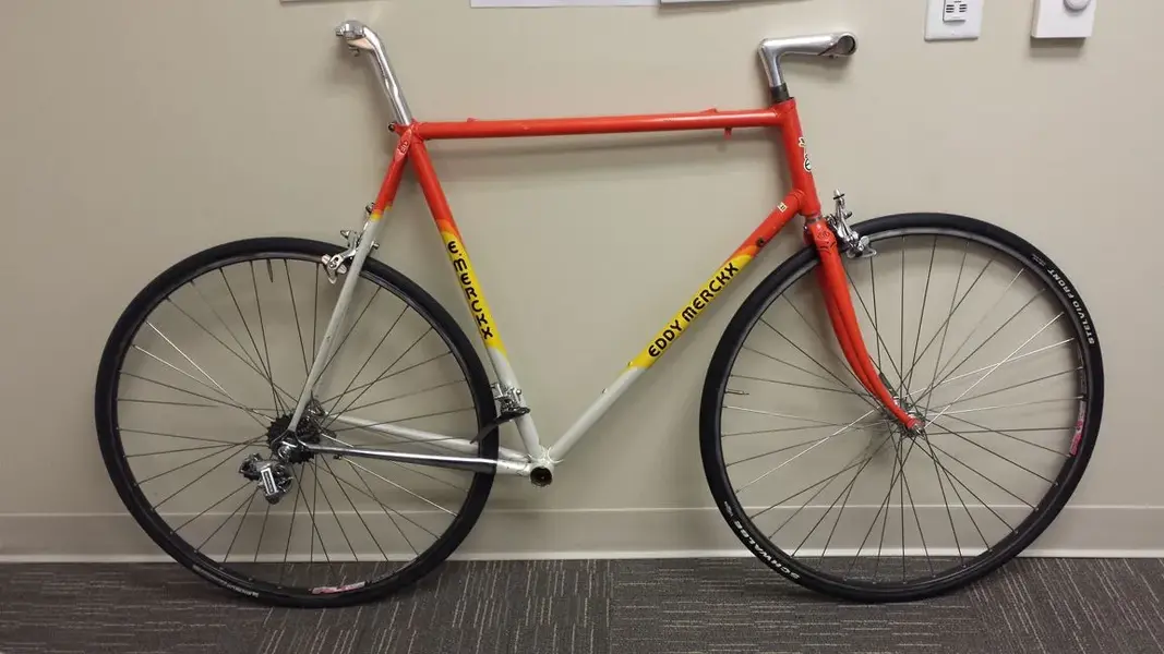

I may very well need that 180 crankset. And after doing an initial setup, I'm now thinking I may need another frame.
In order to match my current bike setup, I need the distance of the middle of the stem to floor to be 94mm and the tip of the saddle (depending on the saddle I suppose) to be about 103mm. In the attached pic the seatpost is maxed out and with saddle I'll be at about 103mm, but the stem looks pretty darn high so not happy about that.
Based on frame specs (ST= 60cm c to c, TT = 57.5cm c to c) the thing should fit me perfectly but I think the short head tube (175mm) is killing me.
Gah...
