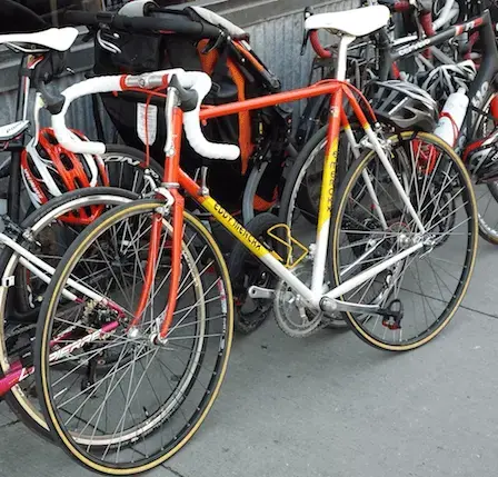

The lever shifts actually properly and does move to the proper vertical position. Switching the boss adapter 180 puts the shifter in an incorrect position so...the mystery continues. Might be time to take it to the vintage road bike shop.
you need to ask a truly vintage mechanic!! :?
now, if i remember correctly, i think that with one version of those levers, the "light action" model, you fitted it as follows:
grease the gear lever boss on your frame and fit the silver mounting collar over it with it's notch at the 10 o clock position as you look at it,
push the lever on to the boss and let it hang vertically down to the ground,
fit supplied washer(s)/ plates etc and screw in the butterfly wing bolt in clockwise until it was almost starting to bind the lever against the boss,
then wind the lever itself anti clockwise over the boss until the play is taken up and then screw the butterfly bolt in tight to secure the lever in place.
i think that this lever rested in roughly the same position as shown on mine in the photo below. the whole idea of this was to give a "light action" lever that was already biased to rotate in the clockwise position (towards the rider's knees) thus making the shifting of the front mech easier.
8)
Worked like a charm, cheers mate.
