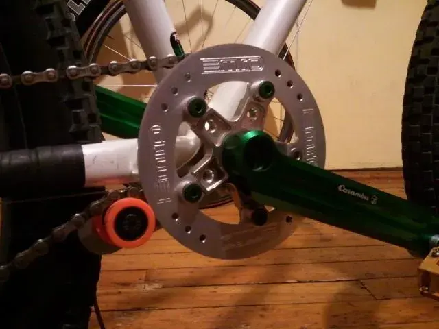

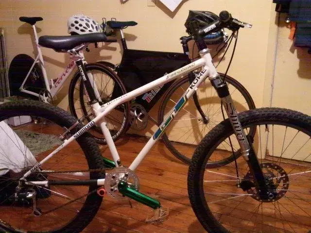

Finally the Christmas shipping fiasco is over and my parts arrived this afternoon. MRP chainguide and Kore seatpost installed but I'm not sure the post will stay. something about it just isn't jiving with me.

Frame that short needs a setback seat post of some type and it had better be a 400mm so it's in the seat tube far enough that the frame doesn't get damaged. That fork looks like an accident waiting to happen. Notice that your bottom bracket is actually angled up above the height of you rear dropouts. I have two 97 Psyclone frames (though not 14's) my rear stays are level to slightly angled down not angled up to the BB like yours.... that fork axle to crown has to have that riding like a complete chopper? Looks very laid back and putting way more stress on that head tube then it was engineered to have...it's going to fail on the under side of the down tube.
have to agree with Kevin; it was never meant as a DJ frame, and won't hold up in that type of build, much less use.
Yes, the Kore rail clamp area is bulky and tall, which doesn't look right. Kore made posts that weren't like that.
I agree it would probably not hold up to DJ use but banging it around the neighborhood to the store or bar I'm relatively sure it wont break. The pic looks a little funny but the chainstays are perfectly level when the shock is at full height but for the vast majority the time I'll have the ETA engaged making the crown 50mm lower. I'm also thinking about switching the fork to a shortened z1 or maybe (and thats a really huge maybe) a yellow Judy SL. On the seatpost I'm going back to the long setback one because I like it best and it makes the bike comfortable.
