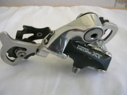

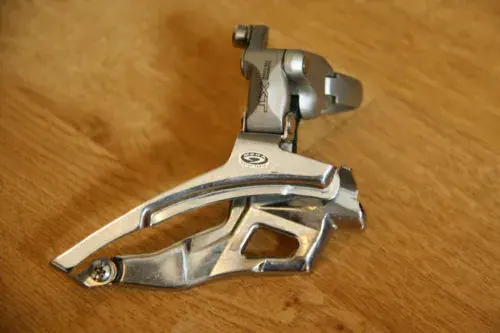

Will these 9 speed Derailleurs work on a seven speed setup.

the mech was designed for 8 speed but will work with anything from 6-9
the front mech should also be fine, but not 100% sure
So long as the mech will move from the small sprocket to the big one when bolted up then it will be fine. Then set the stops and the b-tension screw.
