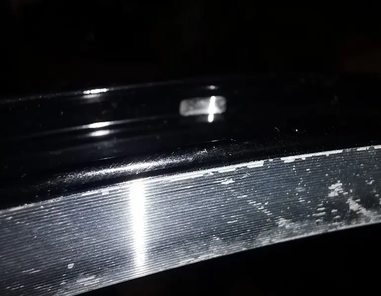

A little dip on the inside of the rim, probably near the labels or valve I can't remember. You know they're warn out when they get a hole.
Some mavic also used a milled band all around the rim on the braking surface, I think.
I did a google search on this. I found numerous references to 'there should be marks on the inside of mavic rims' but nothing definitive, and no pictures.
I went back to my pile of old rims and cannot see any marks at all. And certainly no holes in amy of the rims, even the most badly worn.

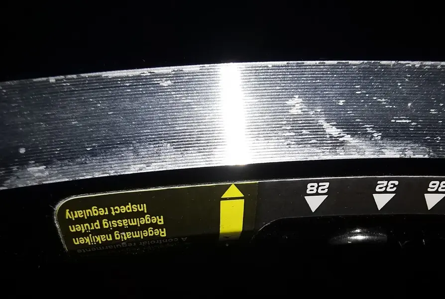

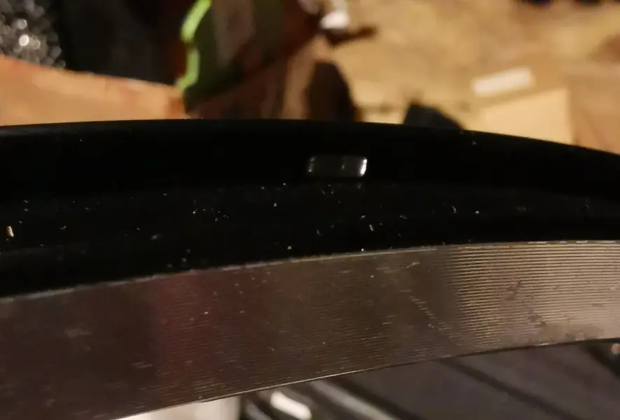

Here are the nicks, one on ech side, they are where the yellow arrows point to.
If they are not there then I think they are pre 2004 (I have a silver one without them and a different label, and two with them. All my black I looked at have them).
It is quite deep, so they don't allow a lot of rim wear by the looks of it, probably 1mm deep
If I ever get them out the loft again, I'll try measure it.

Thanks for the pics, they were a great help.
From my 11 Mavic rims just 2 had the arrows on the label and marks shown in the pictures
The 2 that did were older, silver rims. None of the black rims, including the new, unused rims I bought a year or 2 ago had any arrows or marks at all.
Fluffy Chicken- this is the opposite of what you have observed. Seems the addition of these wear marks was a bit random.
