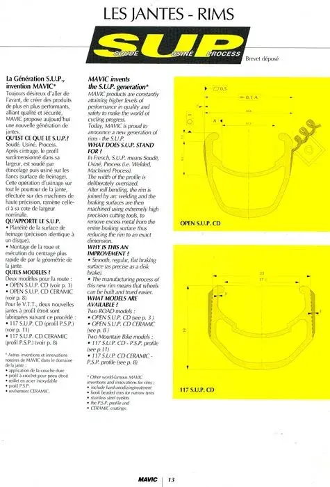

I was looking at these as a "swap" for my sprints and tubs..I think the SUP is related to how the two parts of the rim are welded together so as not to create a "join".
