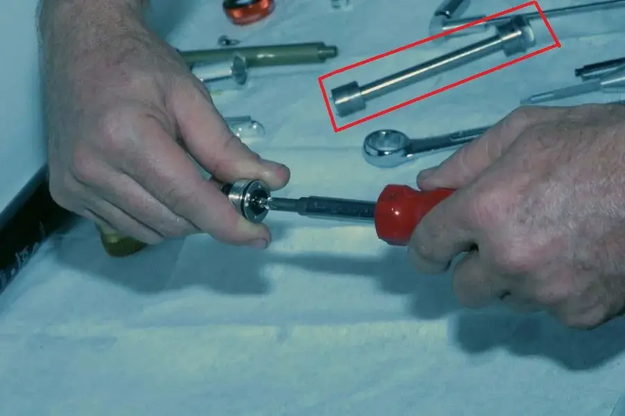

Absolute long shot but does anyone have the special 2 pin tool used to unscrew the upper valve head from the seat post?
I could probably get something made but if someone has one they would give/sell/lend me that would be fantastic.
Failing that if you know of one somewhere, I'm happy to chase a rainbow (well to an extent anyway)
Unfortunately what needs to be unscrewed is set a good 15cm inside a tube with a narrow diameter, the proper tool which I have only managed to find a crappy picture of looks to be machined out of alloy, is about say 17cm long, has the two pins on the end and a hex for operating with a socket on the other.
That is quite possibly the worst written description possible. I have found a picture, it's in the background though and not sure how well it will come out on here.
That will be tricky to make if you dont have access to the cap in order to work out pin diameter and distance apart.
I hate it when stuff is made that requires special tools, dont even mention cannondale headshoks grrrrrr.....
You probably need to attach a disc to a rod with plasticene on the end to press against the cap to get impression of the pins, maybe cover the plasticene with a smear of grease so it wont stick to the cap. Then buy a cheap 3/8 socket and grind down to correct shape.
I doubt it will be easy or cheap to find/buy/borrow the correct tool.
