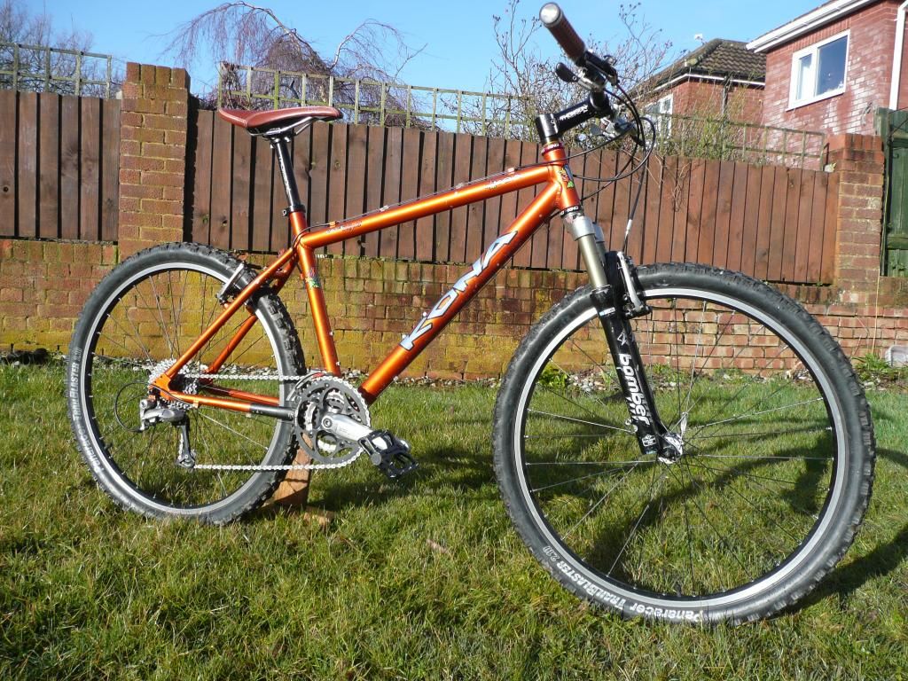

Thank you for your reply and you are 100% correct, they are 2000 forks. Unfortunately though I think it's more than just a quick pump up. The 'O' ring in the top cap could well be suspect as you pointed out. I've taken a couple of quick images of the bike and the forks so that the join can be seen which may give a better idea what i'm trying to explain. A picture paints a thousand words and all that........
I know it isn't a minter but I built it to ride it so it'll pick up marks and scratches anyway.
