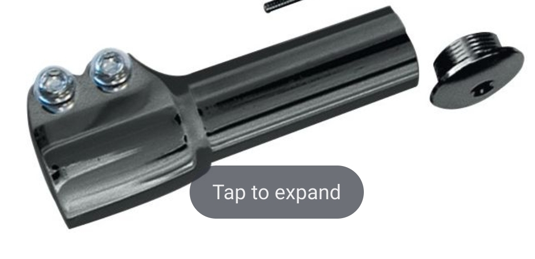

If the steerer tube in the fork is long enough to work but you want to raise the bar significantly, then don't change the steerer, use one of these: Screenshot_20240529-081022_Firefox.webp
this replaces the stem, which then mounts on the top end.
I've even seen 2 of these used together.
Your lbs will sell them👍
