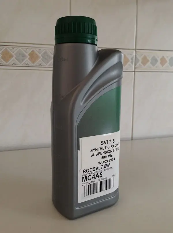

Hm, the seals are on the way, next Friday I will get my fork... :D
What oil do You recommend? Motorex?

i just bought some cheap stuff off ebay that was £7 delivered. you aint gonna notice the difference

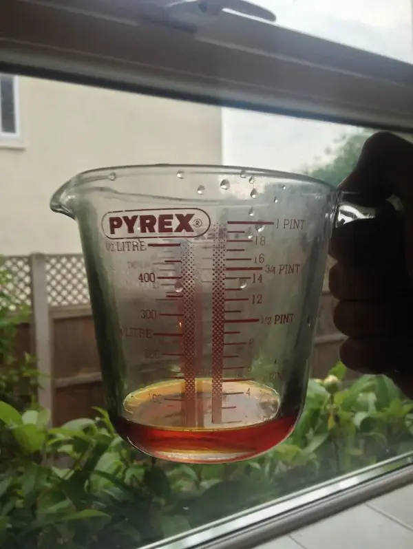

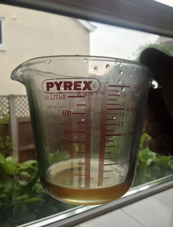

I've changed the oil, measuring out the same 50cc (50ml) as reccomended in the service manual.
ive lubed up the seals and put some in the legs, then reassembled the forks and now the sanctions move nice and smoothly/plush. Now all i need is a shock pump to get some air in the old marz
old oil
new oil

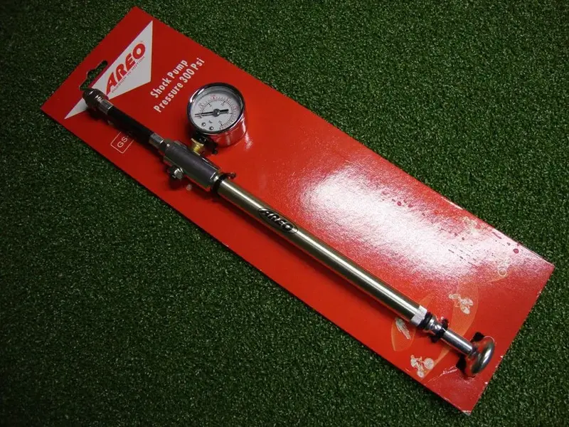

its just a waiting game for the pump to arrive now, if the forks hold air (fingers double crossed) then all i need is a new steerer tube and some graphics then they should be ready to be fitted onto the bike
Sean

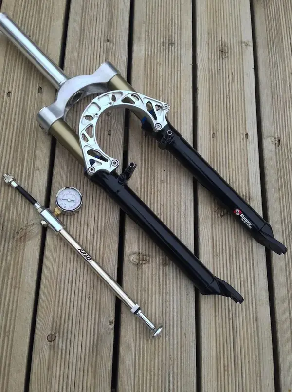

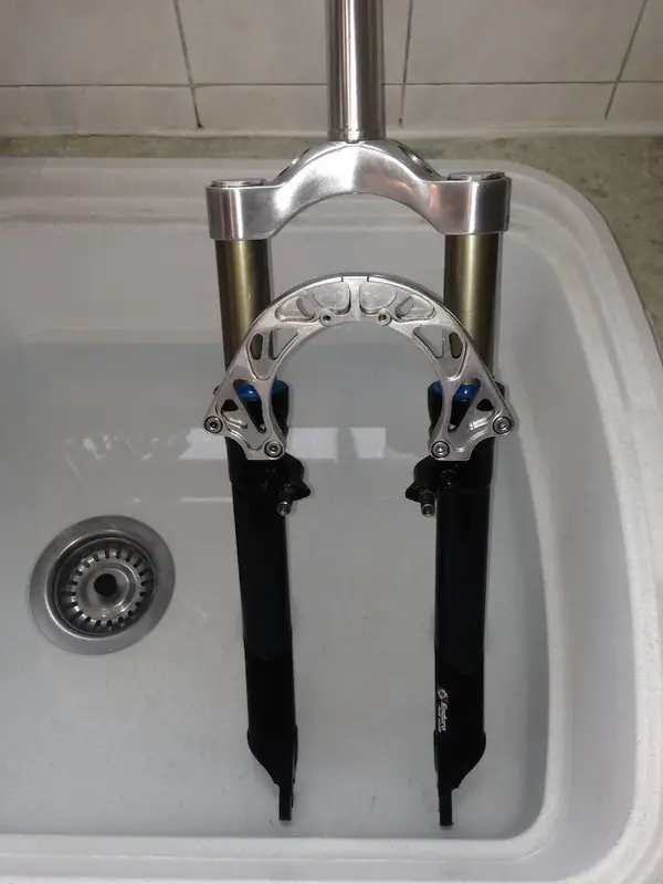

the pump has arrived, so ive pumped up the legs they've passed the water test (no bubbles!) so now i have a perfectly working pair of classic bombers :D
im still keen to get the crown refinished, i was talking to one of the guys at Argos cycles in Bristol last week and he said they'd enamel it for £40 so i might as well do that seems it would cost £25 in rattlecans for me to do it myself. either that or i could get it anodised in black... food for thought
