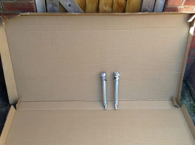

My DIY paintbooth is all set up
1st coat of etch primer

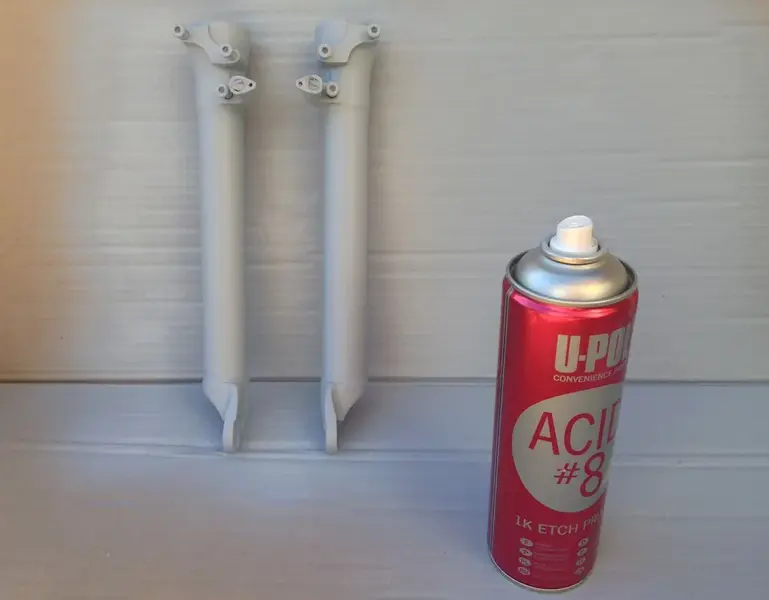

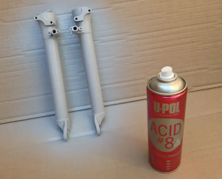

7 coats of etch primer later....

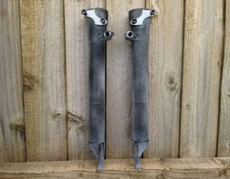

Luckilly its about 20 degrees outside today so i left the legs in the garden to bake for 3 hours while i visit the gf and the paint has hardened nicely. ive prepped them for the top coat and smoothed the surface with 2000gritt wet and dry paper
On goes the first coat of satin black. i chose satin over gloss because satin gives a smoother finish and I've found it to be harder wearing
