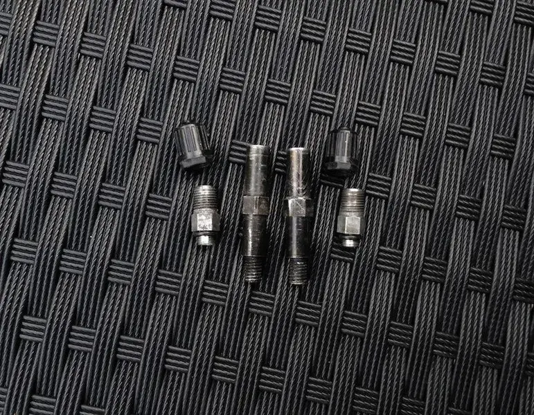

now the bushings are out i could spray some WD40 down the rear of the threads of the the air valves, they then came out really easily.
the brake studs are out as well which makes work on the legs much easier :)

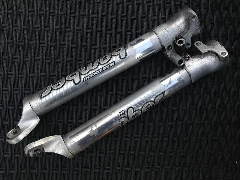

work on the legs has now began...
i wanted to keep as much of the shiny surface under the stickers as possible to make a better finish once polished, but due to the amount of residue left behind they had to be sanded

Word of advise having done this recently.... And regretted it.
Refit the air valves and mask them up prior to painting (if you are going to), as I found masking the holes ineffectual, and now I have to clean the very fine threads of paint before I refit the valves
Incidentally, can you poss measure the o-rings on the valves...? Mine came out in many pieces and need to find some new ones
thanks for the advice, i might insert a bolt the same thread size when painting, that way i dont risk getting paint on the valve itself...
Re: Re:
SEANSTEPHENS":2ys688b8 said:
If they are M8x1 use a crank bolt
If they are M8x0.75 use a chainring bolt

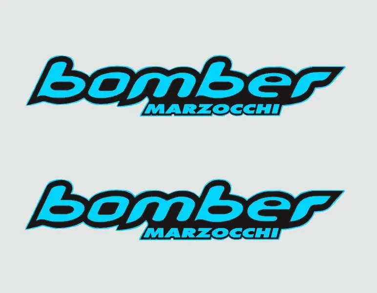

Angyalpor":316w21hg said:
Wow, nice work, nice... :)
Have You got stickers for it?
I dont have any stickers yet cus the original plan was to polish around the factory fitted ones but im gonna have to get some printed Soon. i made this template on photoshop to have a mess around with some colours, its not perfect but you get the idea :)
