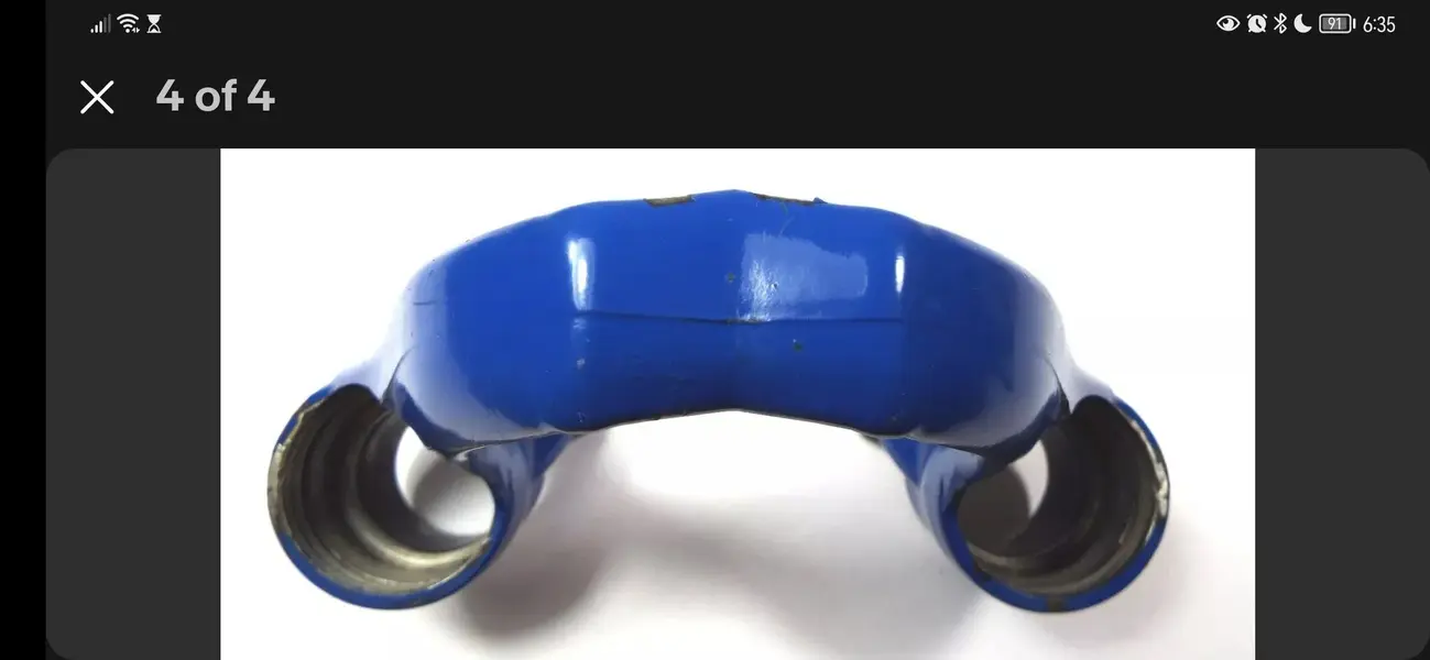

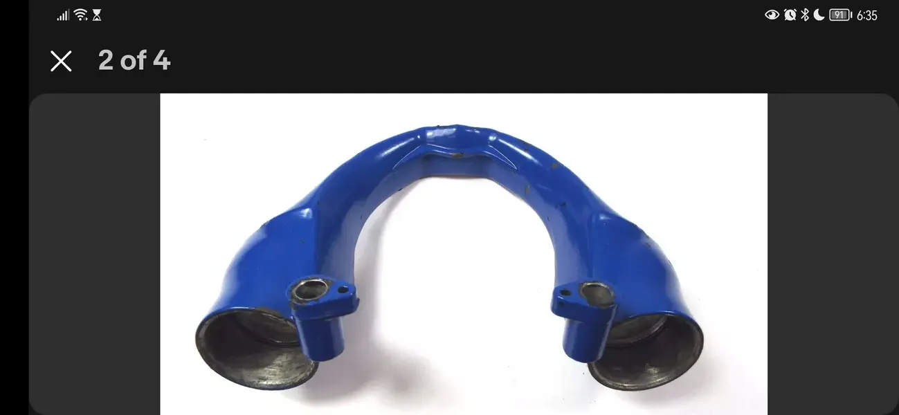

Can I ask why the leg rotates ?
Because it is a cylinder in a cylindrical hole.
The the brace is cryo/bonded/... (not sure, not really looked in to it) and secured in place by the canti bolt (or replacement bolt if using disc and you really think it needs to look tidy). Otherwise the usual forces from the independent leg movement, the well twisting etc, just break whatever seal there was.
The warning.
And some photos from someone trying to sell a spare they pulled from a fork.
The the brace is cryo/bonded/... (not sure, not really looked in to it) and secured in place by the canti bolt ...
Correct. And the forks using this '3 parts casting' I have opened (some X-Fly's) had 2 seals (o-rings) on each side in it to seal it.

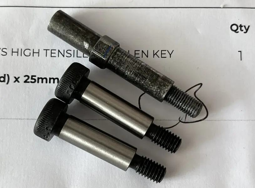

I too have a set of Flylight Airs on my Kona Stuff - nice set of forks which like yours have very slight oil seepage at the joint but hold air just fine. I've just taken a chance on these shoulder bolts from eBay (https://www.ebay.co.uk/itm/200994813385?var=500206016465) so I'll update if they fit 🤞
Ha! Nope - thread is far too coarse (apart from the fact that I also mis-measured the shoulder) 😞 Guess I shall just have get used to the look with the brake studs in place.
