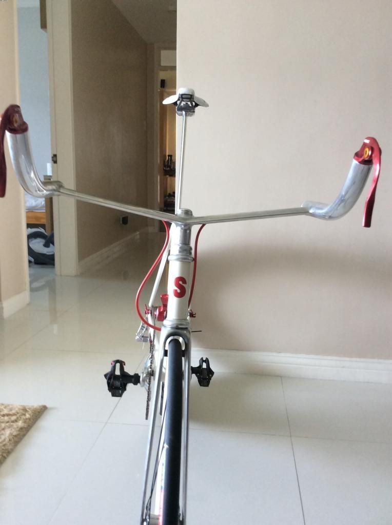

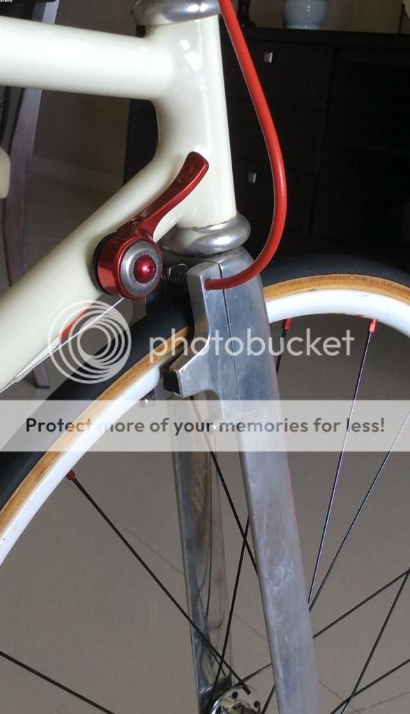

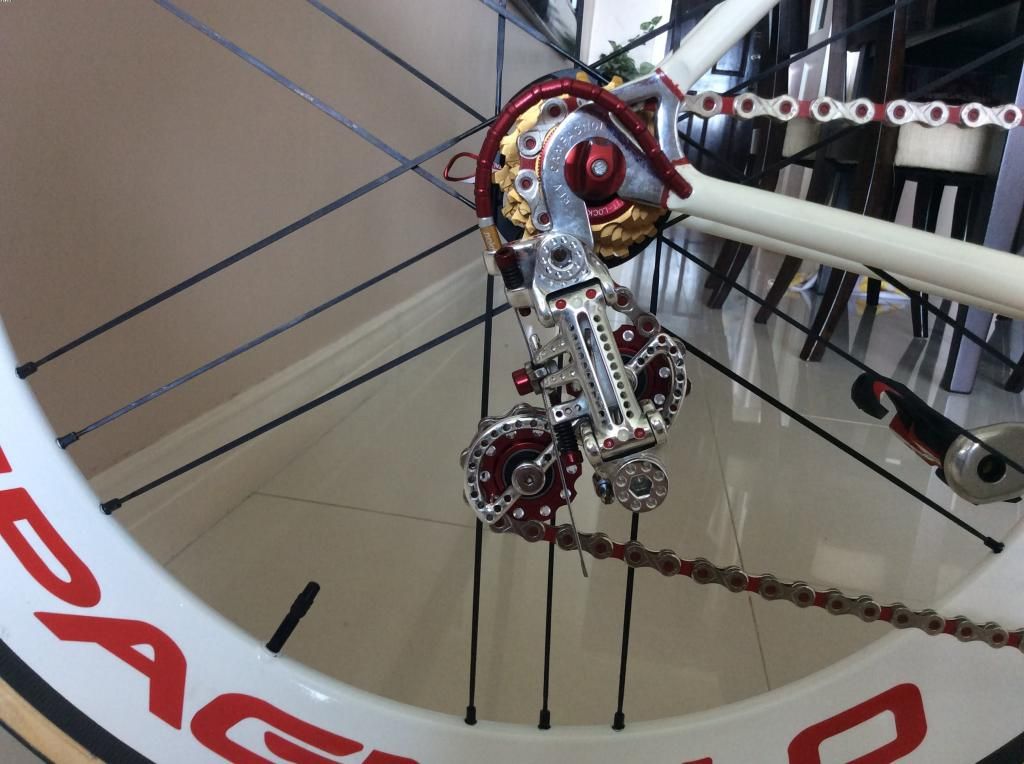

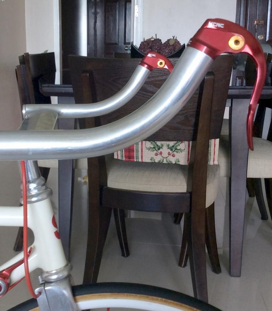

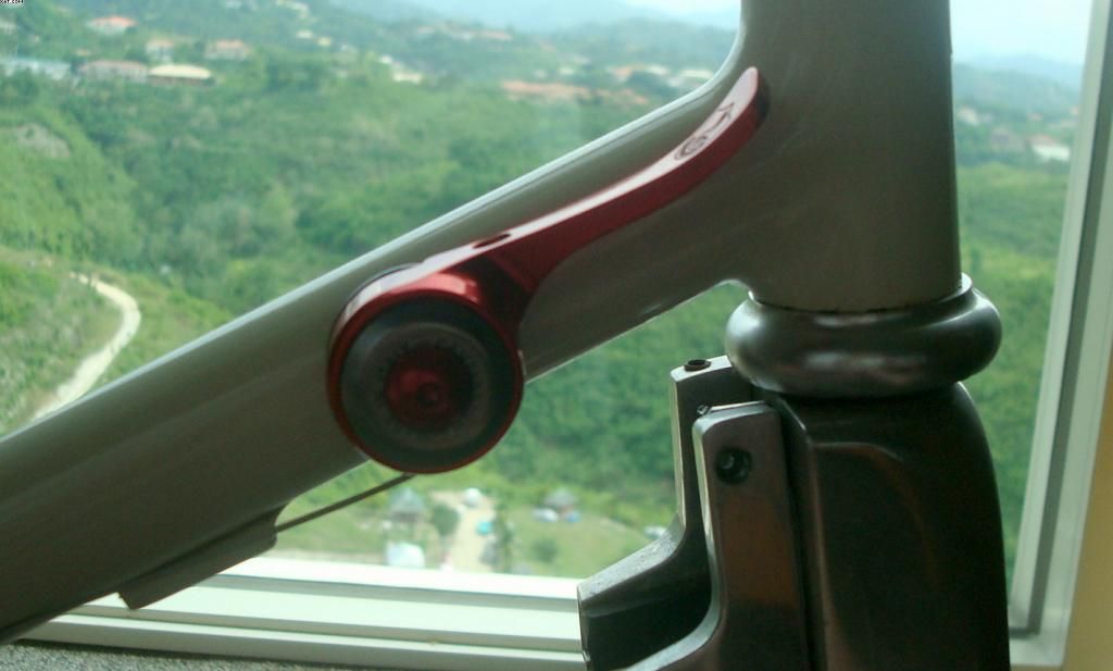

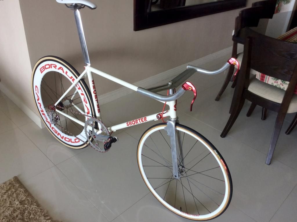

I have taken my 10 speed Campag Bar end lever & have modified it so that it will work on the down tube of this bike having a 10 speed cassette although only 6 cogs are in use. Still to be tested but does work OK. Can always go back to friction if not though.
Very nice mate, you adding a red anodised gear cable end cover ?
If you don't want to crimp the end and make it look a mess, all you need to do is put a drop
of super glue inside the cover, heat the cable end slightly, then put it into the cover,
the heat will make the glue cure fast and will be stuck fast, very neat.
http://www.ebay.co.uk/itm/10-RED-KCNC-A ... 338f6602d9
Yes Ian I was going to add a silver cable end fitting but your idea of red sounds good so thank you. :)
Will mount these levers to see how it looks to the overall scheme of the bike as the black levers although nice don't quite look right...........

Added the levers on the bike which look more in keeping than the black. Still need to tidy up the gear cable & gears.
