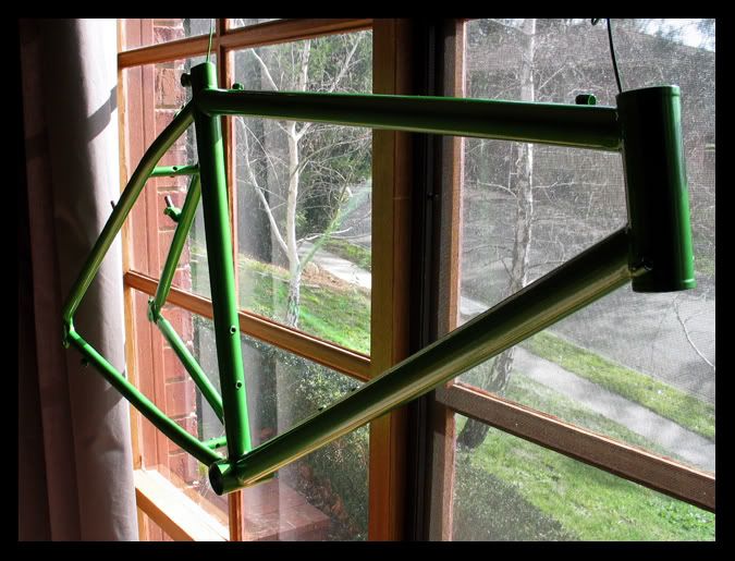

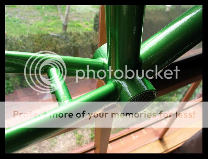

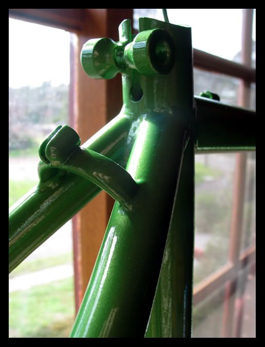

Well the painting is done. I just finished the frame 30 minutes ago and have brought it up from the garage to hange in the house (nice and warm) for a few days to harden. Sorry the frame pic is average, but I don't want to touch it again until hardened and the light was behind it.
I did 2x coats of Etch Primer, 3x coats of Colour and 3x coats of Clear. I went a bit bolder with the green (compared to the example colour I posted earlier) and am glad I did as it'll really contrast with any red bits I put on. Its a metalic green which is not showing up too well in the pics.
Overall it came up pretty nice I think:
I have not even thought about what parts to put on as it is meant to be a budget buildup, but the plan is to have the bulk of the parts black or silver and then to throw in some red highlights. Would love to get a set of Girvin forks for it though!
Cheers,
AJ

nice colour, and done yourself... looks like a nice job.
Only time I sprayed a frame myself I got impatient building it up too soon after painting it and buggered it up... though I know where I went wrong I've not been brave enough to go back and try again.
BG,
It’s pretty easy to get an decent job with a spray can, but as you eluded to... impatience is usually a major contributor to a job not working out too well. So too is paint quality/choice and prep work.
Being winter here its cold out, so my plan is to just leave it hanging inside for 3-4+ days. Thankfully that will be easy given I have no parts ready to go on it yet ;-)
AJ
