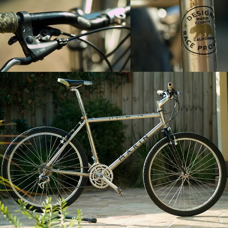

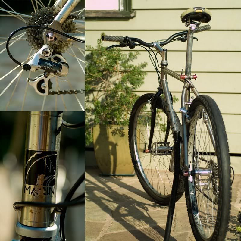

Just purchased what I believe is a 1995 Marin 'Team Marin' and wanted to post some pics to get your feedback.
I checked the 1995 German Marin catalogue and there seems a few differences. So I'm not sure how much on mine is orig or not.
Any pointers, feedback or advise on the bike and its originality would be greatly appreciated.

My knowledge of Marins isn't sufficient to tell the year really. 95 could well be right, but if it is, most of that gear is older than the frame and forks.
I'd say its older. 1993. But very few of those components are original. Cranks look like XTR M900 which would be right for a Team Marin.
IMO it looks like its been used as 'donor bike' for something else to be upgraded and had loads of ad-hoc parts thrown at it to get it rideable again.
No problem though, you'll have fun restoring it, the parts you'll need are accessible and it'll still ride great in the meantime.
Welcome to the site. :D
Hmm. I think I'd err with Kev- rear hub look newer than 93 and the rim look wider than I would expect, other stuff looks a bit hodge-podge. DX front mech on the Team?
Cranks do look M730 and I want some of those Ritchey Logic canti's (think mine got binned from my parents house).
Aaron, if it's not rude, how much did you pay? I only ask cos decent retro bikes seem to be thin on the ground her in Oz. Wish I could find something like that without having to ship from abroad... Have fun restoring it!
Cranks do look M730 and I want some of those Ritchey Logic canti's (think mine got binned from my parents house).!
Cheers Geoff :wink: DX front mech, M730 rear mech and XTR M900 cranks. None original.
M730 cranks have SHIMANO engraved into them. No amount of heel scuff can polish it off :D
The Ritchey canti's are nice. Basically a DiaCompe 987 IIRC.
As I said though Aaron, not putting your bike down. Its a great basis for a project and will definately be worth the effort of restoring, or just thrash it as it is.
DX front mech, I'll grant.
M735 rear mech - original.
Those cranks aren't M900 - the profile of the arms isn't right. I take the point about the SHIMANO stamp on the face of the 730 - so how about Deore DX?
I'm pretty sures thats not an M735 rear mech! And possible the left and right cranks aren't a pair :shock: Not Deore DX either - they were stamped DEORE.
Maybe Aaron will confirm the part numbers of all his components?
Aaron - common on buddy. Settle an Anglo-French disagreement :wink: :lol:
