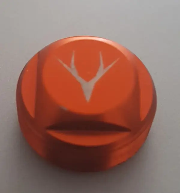

I am trying to source the quad link lug caps x 8 all are missing and was going to change all the bearing but needs caps to protect the bearing once changed. Can anyone point me in the right direction to obtain them please. No joy with Marin dealership :(

i'd look on ebay for rubber bung/blanking grommets which come in various sizes (after measuring the size you need from your frame)
Okay that's not a bad idea, was try to fit a cap as oem over the 10mm nut, looks like a mini top hat. But I could fit a rubber blank under the nut. Would this not compromise the torque setting for the suspension?

Your a star, Just ordered one to make sure. Quite confident it will as you stated and I have read Whyte parts are interchangeable.
Plus points it comes in different colours, I will definitely let you know the outcome..
Thanks Fuxuk
Finally arrived, need some filing down but fits. Need to buy some M8 thin nylon insert nut as original lock nut to big for screw on cap

Will be ordering the other 7 Whyte Cap ( yes I know they're orange) Whyte is the original Marin designer. He has since departed company with Marin however his own bike designs incorporate the same type of suspension.

Hmmm hit a bit of a stumbling block, need to purchase some nylon insert lock nut, however they need to be thin/slim type as the caps I have ordered are fitting the quad link housing but would screw down further and be more secure if the lock nut weren't so big.
Not sure if this would be feasible also but doin some searching online any links to thin lock nut would be appreciated.
