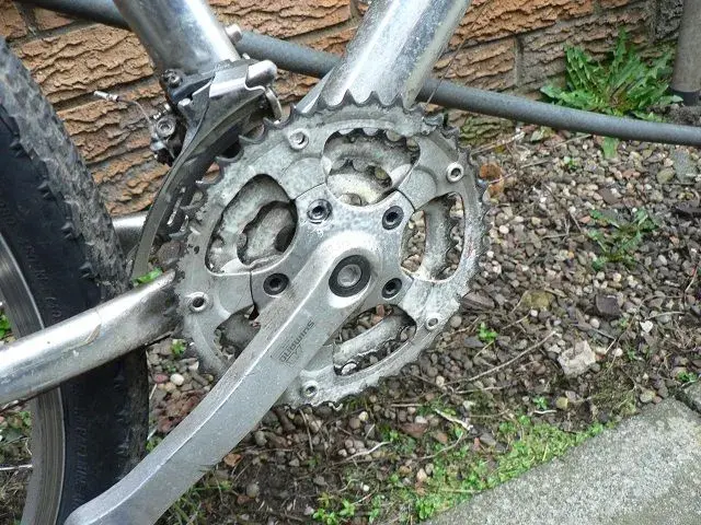

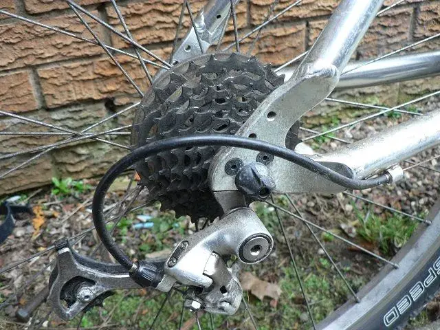

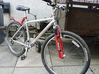

A friend has given me an old marin Palisades trial, but its in need of a new group set,Has anyone any advice on which of the newer shimano gear will fit,
p.s how do i find the age of the bike cant seem to find a date stamp anywhere on the frame.

I bet you don't need a new groupset! A new chain plus cable inners and outers will make the shifting good as new. Flush the shifters through with WD40 as the factory grease tends to harden and clog them. Most Shimano stuff is tough as old boots - there are plenty of people here (me included) riding with 25 year old mechs and shifters!
The frame number is under the bottom bracket. Your bike is from around 1999-2000 at a rough guess.
New Tacx jockey wheels a few quid - or alternatively find a 7/8/9 speed rear mech on here for £10-15.
I see what you mean on the chainset, the outer ring does look worn - amazing as it's steel! With those Alivio chainsets you have to bin them when worn. A nice M563 Deore LX would fit fine and save some weight - say £25 if you look on here. Definitely a new cassette is needed too (7 speed still available new). It looks like the poor thing has been ridden for ages with a desperately worn chain.
A modern groupset won't fit as the rear wheel is 7 speed. 8-speed on would have been forward compatible. There are workarounds, but costs start to spiral.
Personally I'd go with some secondhand bits and tidy it cheaply while giving a minor upgrade.
Even though pictures are not very generous, I reckon it is a 1998 Palisades Trail, from stickers, fork and cranks. 1998 Alivio cranks were already 4-arm.
These came in this polished look and a gloss red. The gloss red one was my first real MTB and I want one back at some point, but only in gloss red.
If I was you, I'd try to get some late 8-speed LX or XT parts. They are fairly cheap these days, pretty functional and durable. STX-RC is not too shabby either.
But first of all, take the bike apart, clean it, dismount the fork, clean it and grease it (it's a simple one), clean all the bits and then add the new ones. Or new old ones. Keep the front derailleur, as this is one of the more tricky things to find in the right size and the proper cable pull direction. 1998 Palisades Trails came with pretty cheap wheels with simple rims. You should also be able to find some nice wheels for a decent amount of money. Whatever parts you choose, add new cables and housing, as this makes a huge difference. Brake pads too. Those bikes had LX-copy brakes and they worked so and so. Other brakes would be a massive improvement.
