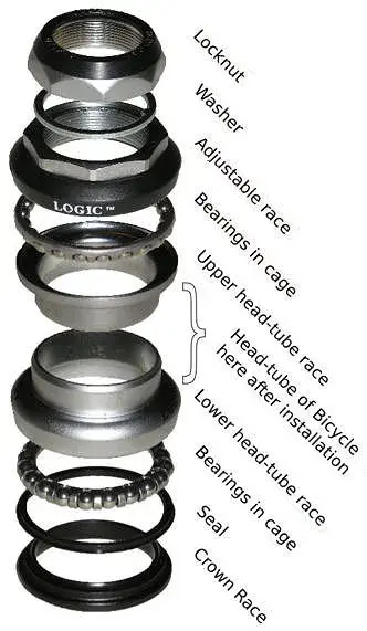

Looks like you've got a threaded headset on there (which I guess isn't original going on the age of the bike).
As mentioned - not sure about the split rings - but should have a tab washer between the upper nuts. What's your method for adjusting and setting up the headset?
Here's an image (blatantly nicked from Sheldon Brown) which shows a typical threaded headset setup......

Sherlylock, thanks for the pic and advice, will send you a PM shortly...

Mart had a look at the headset, and thought that I need a washer between the two top nuts, so will be sticking a wanted ad up for two 1 1/8inch threaded headset washers, I need two as Mart needs one as well!
Simon, I think you might have some alignment problems with the small ring in that position and the chain tensioner, but if it works then I am going to steal your idea. The headset needs a lugged washer between the headset nut and locknut. The lug fits in the groove in the fork to stop the washer and hence the headset nut rotating. It's coming on, eager to see it finished.

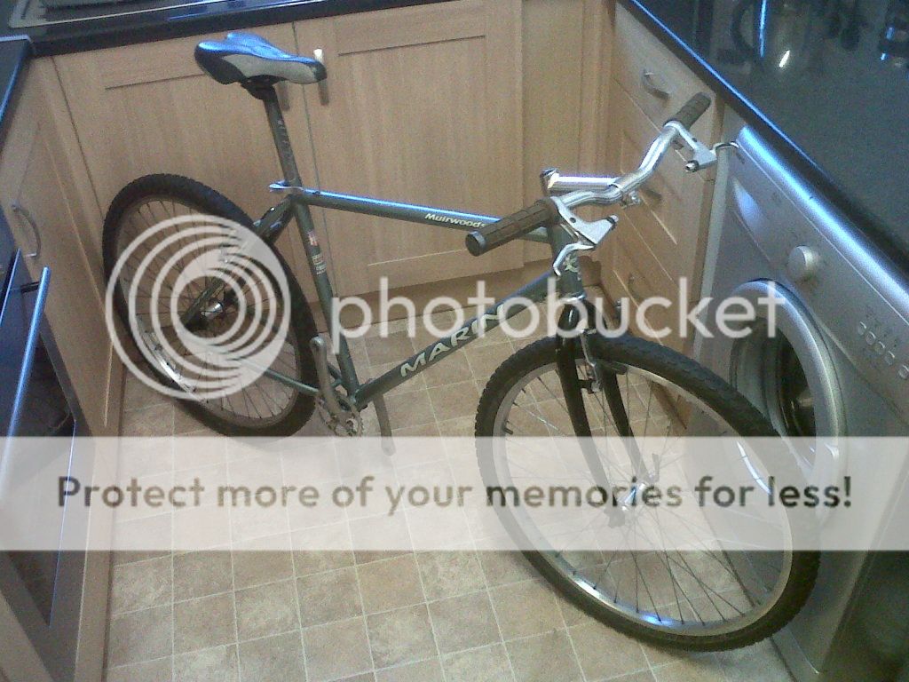

A few more parts turned up yesterday, some nice Marin Alloy handlebars, and some Tektro brakes and dia compe levers. I couldn't resist throwing the whole thing together with anything else I could find in the cupboard:
The saddle and tyres will change as soon as funds allow, you may also notice that the brakes need some cables and a chain would be a good idea. After further research I am still planning on the Haro twin rails...
I have fitted the middle ring from my crank (32T) and had a look at the alignment with a rusty chain:
As far as I can tell alignment is fine from the top, am planning on trying an old derallieur to get the bike going and then playing around with spacers and tensioners later on. I have an 80's Suntour VX that should do nicely.
