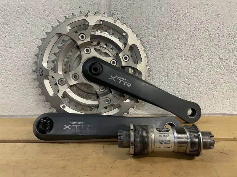

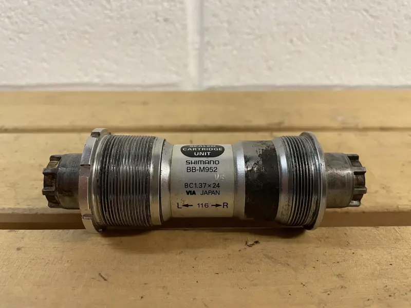

M950 chainsets don’t use a square taper BB.
You need the correct 1st version of the Octalink which come in 112.5 and 116 lengths. These are expensive now at around 50-£60 just for BB.

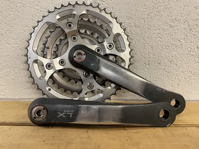

I’ve got two sets of M952 for sale. 1 good set and one with wear.
