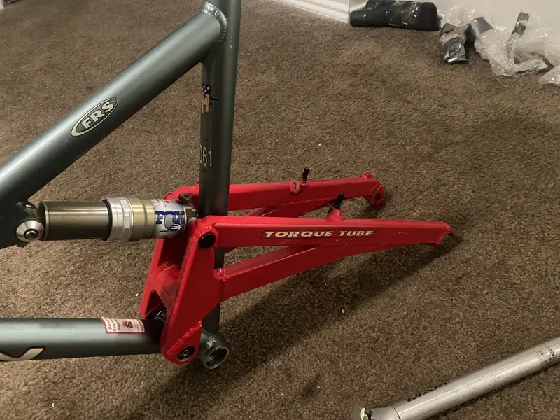

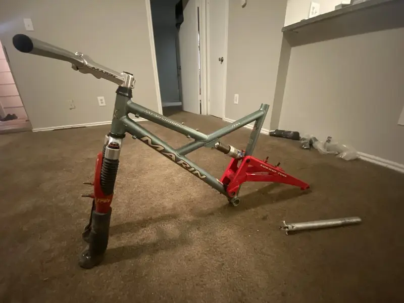

I’ve never ridden a mountain bike of any form, I just recently purchased a 1998 Marin Mount Vision Pro frame with the fork and headset to go with it. Though I’m trying to take all of this information In at once and find myself confused. In my mind I basically want to take the bike and fit it with modern technology, would that be a good idea or even possible?

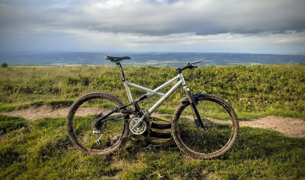

The orange coloured swing arm belooooow had disc tabs welded to it by RB member danson67.
Some inspiration for you
