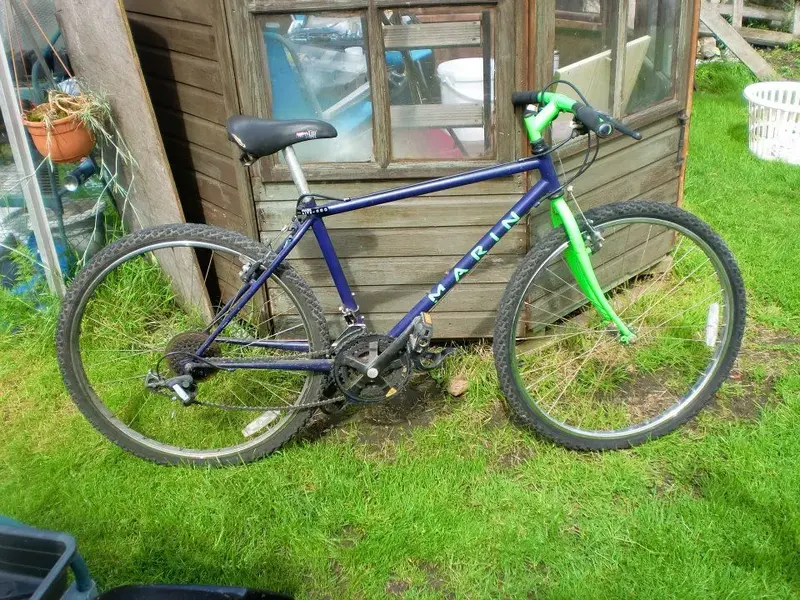

Marin identification help please
The bulge on the seat tube is the butting, it is on the top 5cm.

Definitely looks like a 1992 Bolinas (my first marin and the bike that started the addiction)

Not too important but, that seat post isn't original.
The factory one was a cheapo 2 piece jobby, bmx style if you get my drift where you need 2 spanners to adjust.
Maybe somebody forced a larger one in.....as I say, the seat post is a super rare size that isn't shared on any other marin. To get a micro adjust version would be near impossible, reinforcing my theory of a misfitted seat post.

marc two tone":fwt9empl said:
Here's one i had donks ago.
If you near leeds, call round with it and i will try remove it. freeze spray works best.
http://www.ebay.co.uk/itm/FREEZE-SHOCK- ... SwTM5Y46c1
Don't hacksaw nowt, set fire to nowt, until you try that ^
And she's out!
Got the same freeze spray from Screwfix and on second try i actually heard it crack as the bond broke - amazing stuff, then cleaned up the post and can still see the size -26.6 and a good fit now cleaned.
Post isn't worth saving sadly - but won't be fazed by stuck seatposts anymore!
Got a nice old deore dx chainset to replace the biopace jobby as thats had it, and on with the build now....
Thanks again kind sirs!
