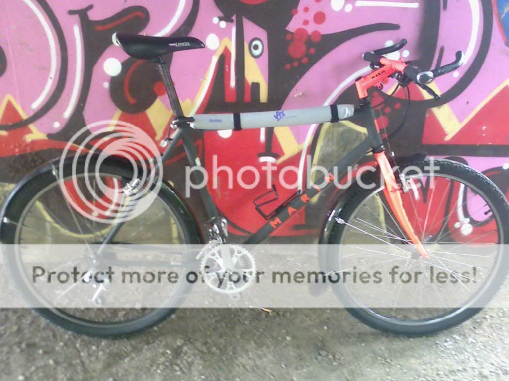

The DX shifters were injected with a load of oil too, feel ok and well indexed. The scratty top tube has been rubbed down and sealed with etch primer. At a distance almost looks like the earlier , lighter zolatone! I have a top tube pad in grey now delivered so, a welcome addition and simple solution to a paint defect.

I've fitted a top tube pad and i'm waiting to find funds for a chain.

Overall a very smooth ride. I found the eldridge a big ol' comfy horse, on the heavy side but, ideal for what i'm going to deploy the bike for.
This type of trail, canal side stuff, wooded trails and other easy and flat sfuff. Afterall semi-slick tyres on hugging the wolber rims.
Original chainstay protector has taken a beating, still doing the job though.
I just can't work out the flouro colours vs lighting conditions? ask wookiee. Sometimes the pics show the bars and stem as 'blood orangey/grapefruit. And then to naked eye, the colours are most definately bright stinking orange. Must not complain, that it what retro is all about.
Mate it is near impossible to photograph accurately the colour of the fluro! I have tried and failed with my Eldridge and the Team photos don't do it the justice it deserves in the flesh!...Fair play for reviving this bad boy and getting it back into the land of the ridden!...1 thing for me...the pipe laggin on the tope tube! only teasing! ....however if you want a mint one I'm selling my Eldridge at the mo!
