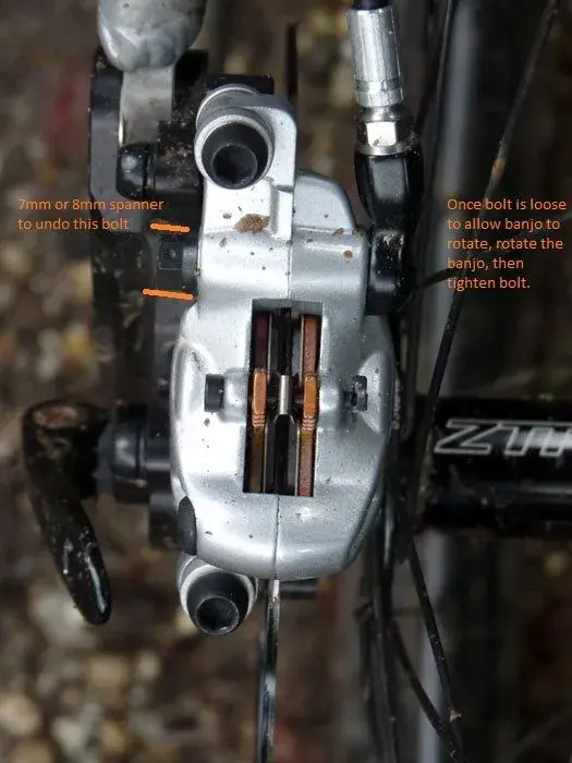

you know you can rotate the banjo at the brake calliper to get better routing of the hose by undoing the bolt just enough so the banjo can be turned?
I didn't but will do that thanks :)
For reference which bit is that?? Sorry if that sounds silly
as below
On the rear, allow at least 10 mm distance between hose and brake disc, last thing you want is for the disc to wear through the hose!!
