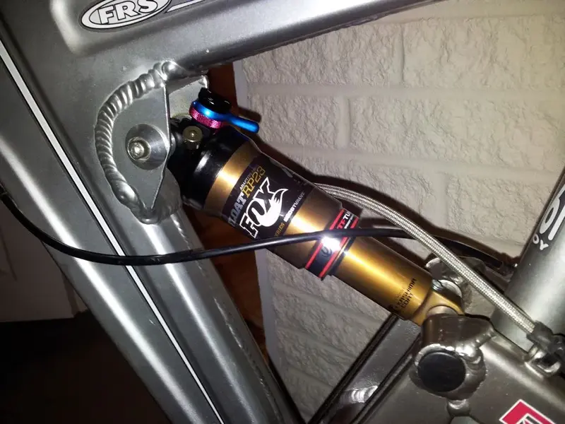

Hi all,
I received the Shock from TF Tuned on Friday, and fitted it that night. The custom mounts were perfect, and it fitted with no problems into my frame.
TF Tuned supply the shock set up to your bike, weight and general riding style. Obviously this is done blind and in this case with a unconventional bike, however my initial ride was very positive. They provide a document with the settings they have used, so you can set it back to default if you play about with it.
The shock is light and well made, and the controls easy to use. The Kashima coating is very shiny! :-)
I went for a brief road/light offroad run on Saturday to test it out, the pro Pedal is impressive for on road work, really did feel much more efficient. (how much is just positive thinking is open to guess work though ;-) ) and while the off road was fairly light, (a gentle descent on horse hoof broken up hardened mud was about as rough as it got) the shock did feel nice and plush and very well damped. I will have to throw it at a rock garden to be sure though! ;-)
Over all I am very pleased with this shock and the service from TF Tuned, I can Highly recommend them.
Cheers
Simon.
