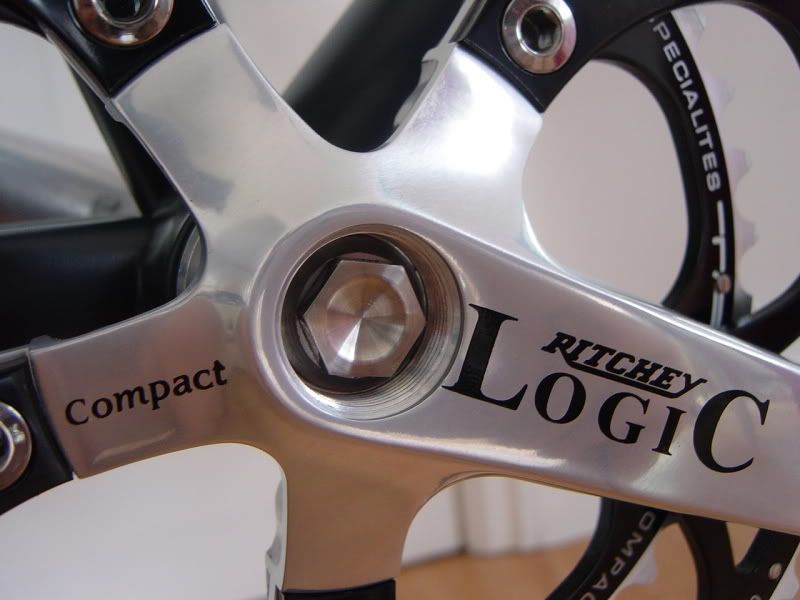

) still, gave me an excuse for a last photo of the tread seeing as how I have never owned one so neat – and it will stay that way as there is no tag washer to start to bugger the thing up :

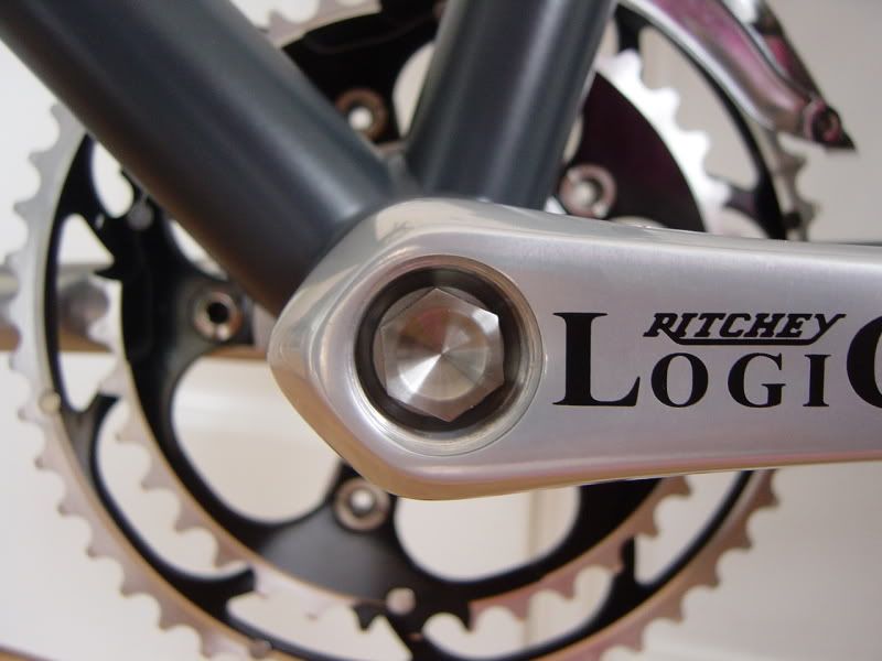

The modified bolts and spreader washers fit well and allow the caps to seat home properly :
and the grooves in the back of the chain ring bolts line up …
Front mech alignment has always bugged me (clamping it up, trying it, moving it etc) but I tried this with the long bolt and it was easy to do :
